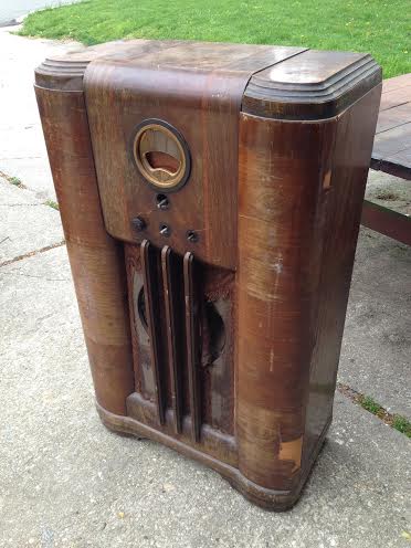

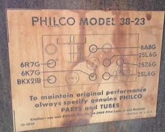

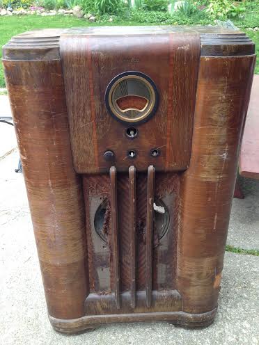

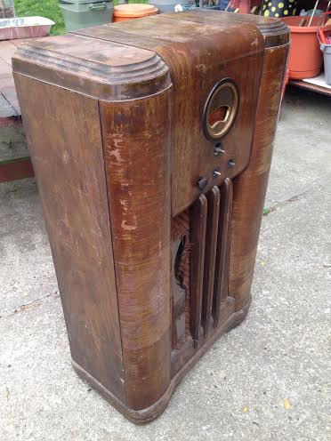

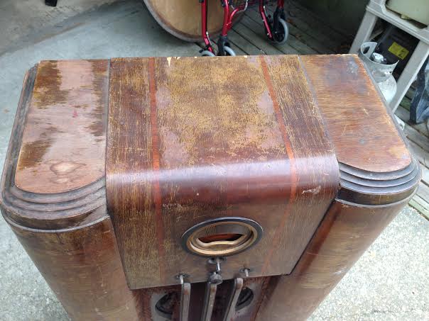

Thats where I found them Ron,
I was asking because it only said 38-23 with no K or X
I picked it up anyway and it is the 38-23X
Needs veneer, cabinet refinishing, glass for dial cover, grill cloth, speaker repair and electrical.
I offered $20 but he made me pay $22.00
Here she is:
AC: 4 DC: 1
Yeah, it won't say 38-23X inside, just 38-23. You have to know which cabinet it is, which you can usually find in the Philco Gallery.
You did well, $22 is a great price for any old radio that is salvageable. And with your cabinet skills, you'll have it looking like new in no time.
Bear in mind that's an AC/DC set - no power transformer - so be extra careful of any loose wires!

Hmm, a transformerless set with push-pull sound. Kinda like my one Zenith. I like these oddballs.
