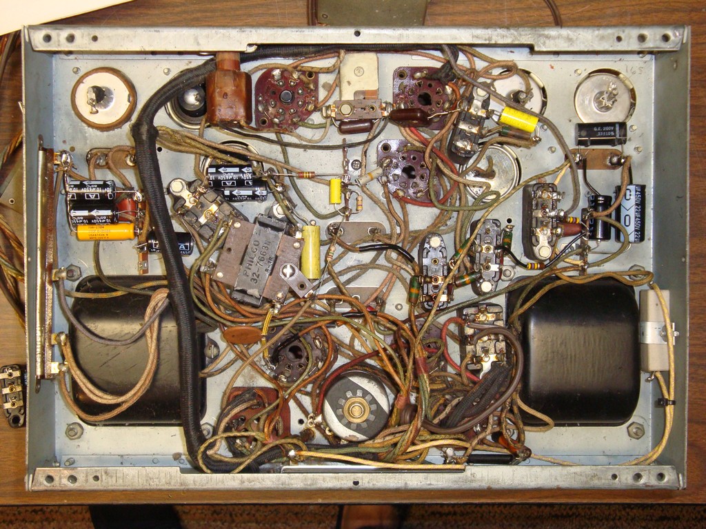

I pulled the power supply chassis out recently to look it over, and I didn't really like what I saw.
[Image: http://www.philcoradio.com/images/phorum...e00001.jpg]
Two bakelite blocks missing...two with terminals broken...all aluminum can electrolytics disconnected and new electrolytics stuffed under the chassis, none of which are rated higher than 450 WVDC. (The original 10 uF caps were rated at 475 WVDC.)
I also noticed that one section of a two-section Candohm resistor had been replaced - and wired in series with the original Candohm terminals.
In short...it does not meet my standards, and I don't want to see it leave here until it has been done over, and done right.
I've replaced one missing bakelite block so far. I have also ordered new electrolytic capacitors from Just Radios - mainly 10 uF, 500 WVDC for the main filter caps. These will be installed in the original aluminum cans for a cleaner appearance.
Now I wait for the Just Radios order...

I received a note from Dave at JustRadios that the caps will ship today. So once they arrive, I can resume work by rebuilding the electrolytic cans, and then proceeding from there.

I use the NP film caps rated to 630V to restuff cans up to 15uf and sometimes up to 22uf. That way no one will have to worry about failure, or polarity, anytime soon. Yah, they cost more, but if someone unplugs the FC speaker and turns the radio on, nothing pops.
So, where do you get these, Russ? That would have been my preference, as long as they would fit in the old aluminum cans.
