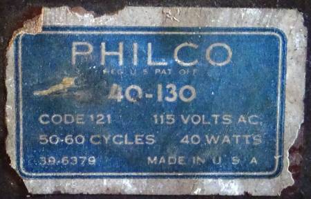

So: USA-made Philco home radios of the mid-1930s intended for sale within the USA do not use metal tags, they use paper stickers.
Examples:
[Image: http://www.philcoradio.com/assets/44label.jpg]
[Image: http://www.philcoradio.com/assets/40130_label.jpg]
As Arran correctly stated, Canadian-built Philco radios of the mid-1930s do use metal tags.
USA-made Philco radios intended for export use metal tags instead of paper stickers. Whether or not the "Chassis Type" has an "E" after it is irrelevant.
