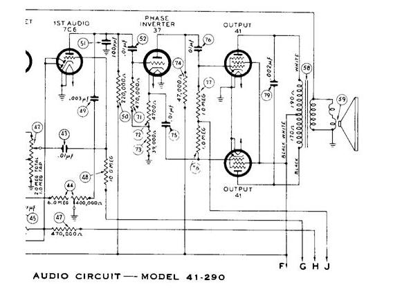

    Got no problem with installing a jack in the back. The problem is that there's four wired going to the speaker and I'm not enough of a tech to know just where to tap into the speaker circuit.
