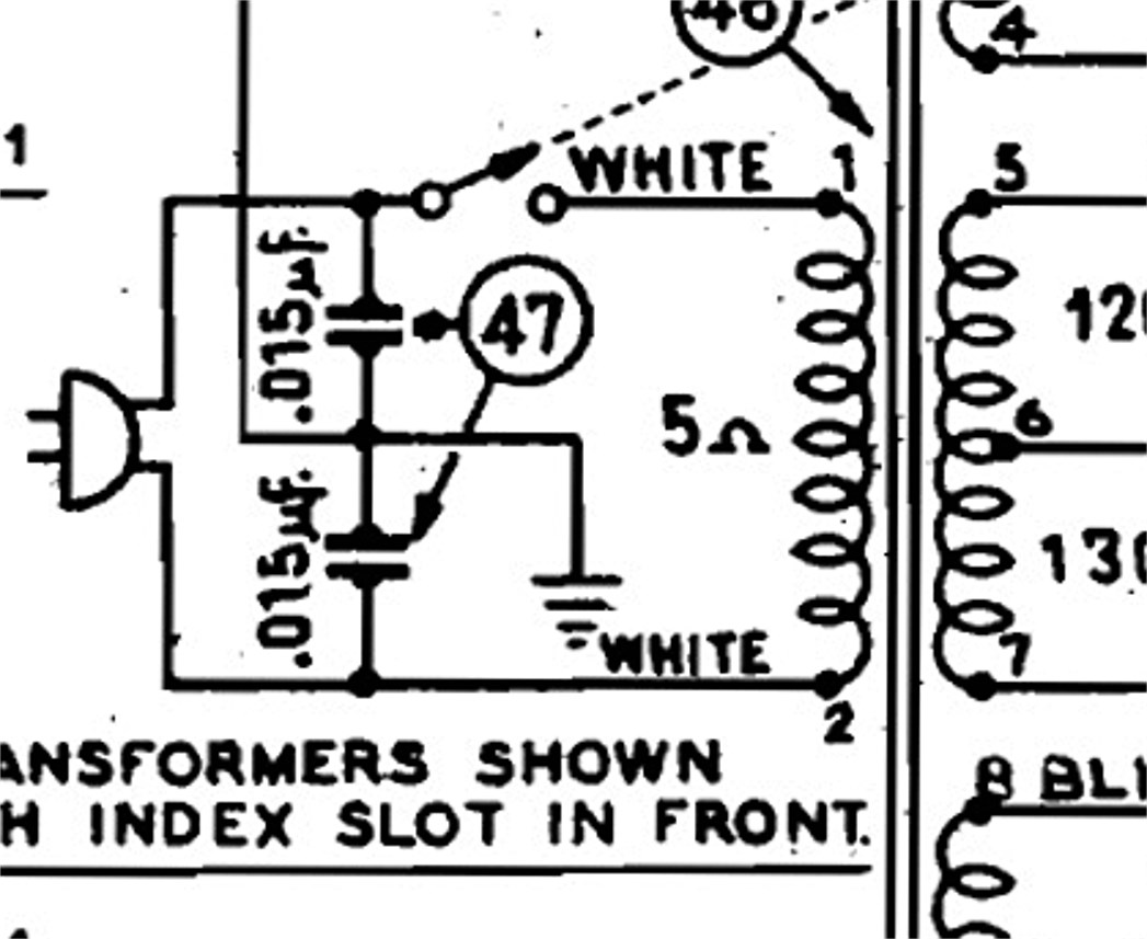

I want to rebuild the bakelite condender on a Philco 38-10. There is only one and it is where the AC comes in. The caps are rated at .015 each. Since these caps will only see AC do I need to buy AC rated caps? Would .015 at 630VDC work?  Thanks

You want 0.015uF Y2 safety capacitors.  I get mine from Just Radios and I believe Mouser has them as well.  I usually buy the 250 v rating.

Actually that tutorial rebuilds exactly that, the line filter cap (from 111 Philco). Parts are similar, mine was 3793-E and yours is 3793-DG.
You can use 10nF or 15nF, for this purpose no difference. As long as they are Y-rated.
