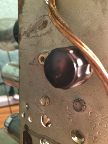

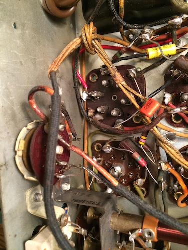

I'm guessing that the same technician who installed the Thoradson output transformer and liked to solder by placing leads next to each other and having at it with the solder gun might have installed this switch? It has an RCA jack, the switch seems to be a simple on/off kind of thing but doesn't click in place--it just rolls to its limits, shielded leads with the shielding soldered to the chassis, and it connects to the volume control through a second .003 uf 1000v cap and one of the IF transformers through a .01 uf cap.

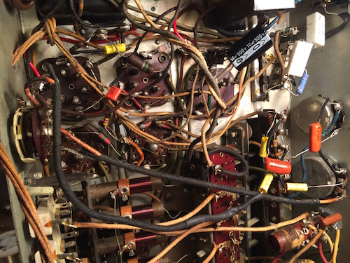

The caps you see are mine...I replaced all of the caps, but I still need to trace all the circuits, and replace some wiring, yet.
I replaced all caps and out of range resistors, but I'm staring at this switch thinking I should take it and the extra .003 cap out of the set before I try to bring the set up on the variac.
Am I correct in thinking this is not a Philco part? Do you think I should get it out of there?
Note: Don't worry, the candohm is not in circuit...that ugly replacement is (I'm going to look around for a longer terminal).

I'm reasonably sure that is not a Philco switch. The 41-285 certainly didn't have a factory phono input. Adding aftermarket RCA phono input jacks and switches to switch them (and disable the radio during phono operation) was pretty common.
You could restore the wiring to stock or you could leave it there in case you want to input audio from an iPod or similar device. If you do, trace out the wiring so you are sure what the switch actually does. A different switch with a clear switch point might be a good idea. It looks like it's probably a DPDT switch, which is needed to do the job right.

Great advice. I'll look in my Marcus and Levy right away. I'm pretty comfortable with the switch, now. It makes no changes to the original circuit and its switching simply places the RCA jack in the circuit or shuts it out. I am keeping it out of the circuit while I troubleshoot the rest of the radio.

There is no guessing at all with this, Philco, at least the U.S made Philco sets did not come with RCA phono jacks. I've also arrived at a policy of removing phono, or any other input or output jacks, for radios that did not leave the factory with them. The reason being is that they don't enhance the use of the radio much if at all, and often cause problems because of the crude and amateurish way that most are typically installed. I've seen so much butchery involved with putting those things in that I really don't offer any quarter to them anymore, so when I see one added to a new to me old radio, out it goes and back to original. There are plenty of factory built sets that came with a phono jack, and there are RF modulators for ones that don't.

It made sense to remove it. I did and replaced the .01 cap on the volume pot. I also found several issues and repaired them. The most important was at the junction of the 1 meg resistors R54 & R53. The leads were cracked, so I've replaced both resistors with new ones (the old ones had measured within tolerance, so I'd left them in place). I re-measured the output transformer from CT to each side and it is higher than the Philco part, but not by much (Philco is 170 and 190 ohms per side and the Thoradson is right at 210 or so per side). I measured each chassis ground and got continuity at each one. Retested the tubes...I wanted to see if there was an issue with the rectifier. All good. Lowest rating was a 7B7 at 60% with 50% as marginal on my Triplett.

Found it with some help from Norm. I went back to look at the candohm replacement I had made. And there it was.
Re-examining the candohm forced me to trace all of the attached leads to their components and I found the issue (which was a basic power supply problem). I had stupidly followed the original techs' lead dressing, and therefore I had C27A and C62 switched.
How it worked at all amazes me. I took the filters out, redressed them, and carefully followed the schematic to install them one at a time. Right now the set is singing beautifully on my bench. I'll let it run for a while to see if anything else comes up, but I'm impressed with the sound of this set. I bet when I get it back in the cabinet behind the grill cloth and bolted in, it will sound amazing.
