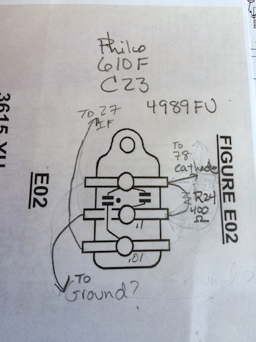

C23 is problematic for me for a couple of reasons, so...
Photos of the chassis I can find online had the same problem the one I have had which is the .1uf cap in C23 was replaced outside of the Bakelite box and R24 may or may not be there. At any rate, i have two questions:
the placement of R24 and the placement of leads going to the 78 tube cathode, IF 27 primary, and grounding of the .01 cap and R24.
Is my diagram correct? There doesn't seem to be a lead for the ground of the .1uf cap and R24 in the set, and C23 isn't a grounded Bakelite cap, either, so I was left scratching my head.

Ah. Pin 4 of the 78 (G3) is a grounded pin, so that's the one right there, yeah?
