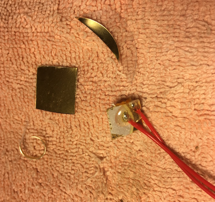

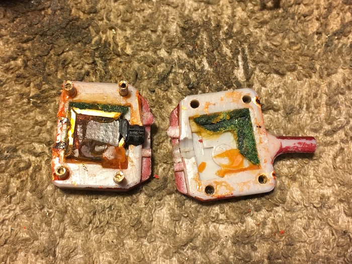

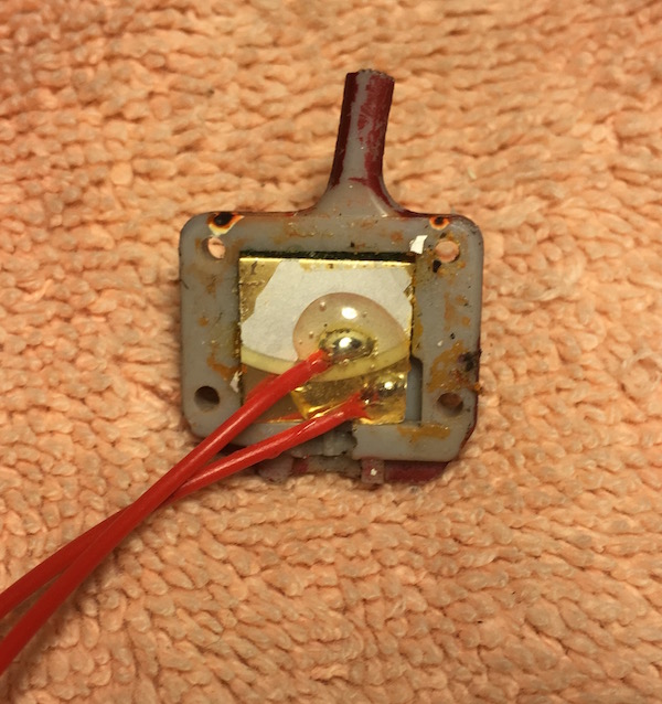

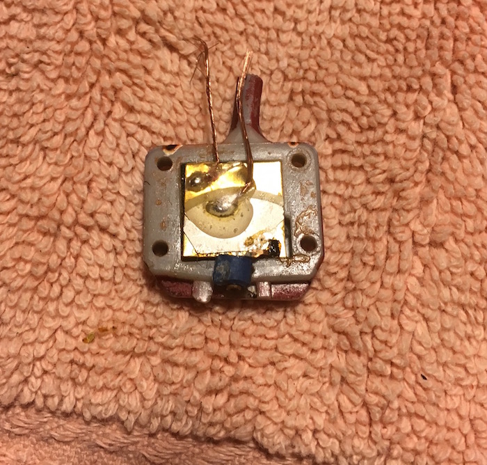

I finally received my new Piezo elements and went to the shop to play. It was a magnetic cart so I cut out the magnetic portion and just wired in the element into the rebuilt cart and directly to the tone arm.
She doesn't have the best volume but she is playing nice. Once I permanently adhere everything in the cart then it should provide more vibration to the needle.
I used Alan's tutorials to rebuild it and just subbed the Piezo for the crystal.
The player was completely dismantled, degreased, regreased, rebuilt, and is lookin good!

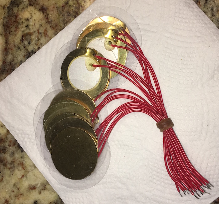

I purchased the Piezo off ebay nice and cheap.
I would get smaller ones next time.These are too big.
This guy has multiple sizes to save on shipping.
http://www.ebay.com/itm/191674434060?_tr...EBIDX%3AIT
Mike,
It could be but I think it is my procedure. I am getting smaller Piezo's so hopefully that will work. Less cutting of the element may just do it. I got the 12MM and 25MM in a group lot on ebay.
Takes 3 weeks to get in the mail though...ugh....
