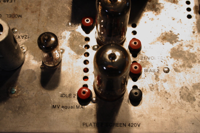

Most of the amps I have use 7868 tubes , a 6L6© variant. So I wanted to test them accurately. I had a good quality mono amp that was set up to run them near their max spec. It was converted into a test rig that can be used to measure the plate current, bias and the interaction between a push pull pair (comparison of plate currents/on known bias).
I also built one of these for 6BQ5s.
You can, and should do this test in the device that the tubes are to be used in - lacking a test fixture such as this. Some modifications may be required.
