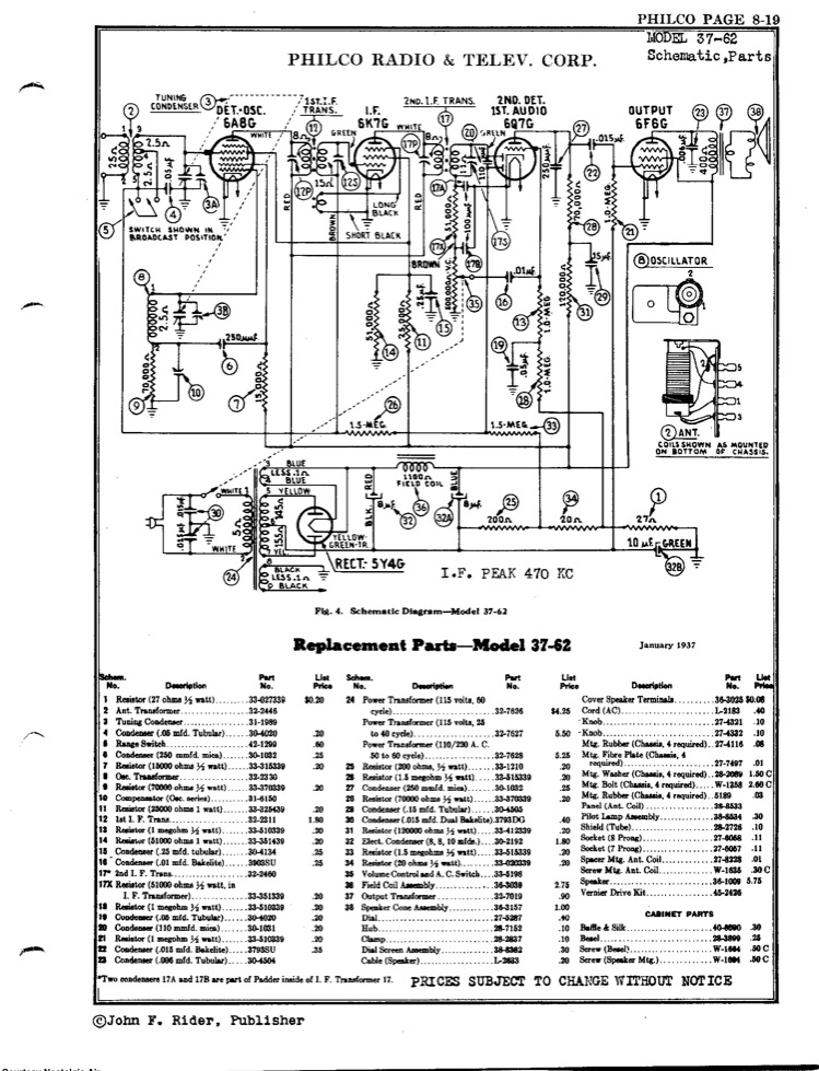

Ever since I've owned this radio, (almost a year), it has had come-and-go problems with the RF amp circuit. It needs a really strong antenna to work passably well. What normally works on all my other radios, you have to multiply it by five for it to work on this radio. It stopped working last night, and I immediately turned my attention to the 6A8G. I put my finger on top of the grid cap and the wire that goes to the tuning condensor and it immediately starts blaring my 1410 KHz AM transmitter tunes. I pulled the schematic, and I'm going to see if changing the tube and replacing the wax capacitors in the RF amp circuit help.

Have you check the antenna transformer integrity yet? #2?
Yup, I agree. If substituting your body for the antenna coil results in a good signal being produced from the 6A8G, then I would suggest that there is insufficient signal getting thru' the antenna transformer into the 6A8G

In the coil #2 measure between pins 1-2 (25 Ohm) and 3-4-5 (2.5 ohm from the center to either end). If it checks out and the soldering / wiring is good, then we move elsewhere.
