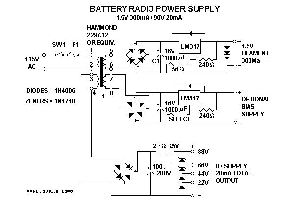

I would like to build a better power supply that does not require a seperate isolation transformer. The one I am building for the A battery supply contains a LM317 showing three diodes on the output instead of a small cap? Could someone please explain this to my simple mind. David

The diodes are most likely there for protection.
If the regulator LM317 should short, it would put the full unregulated DC voltage into the 1.4V filaments of the tubes, instantly blowing them out. The three diodes effectively clamp the output voltage to a max of 2V or so, thereby protecting the filaments from possible destruction in case of regulator failure.

David, if you are building the supply in the schematic you posted, I see nothing wrong with it, really. All the voltages to the radio itself are isolated by being separate windings on the transformer.
