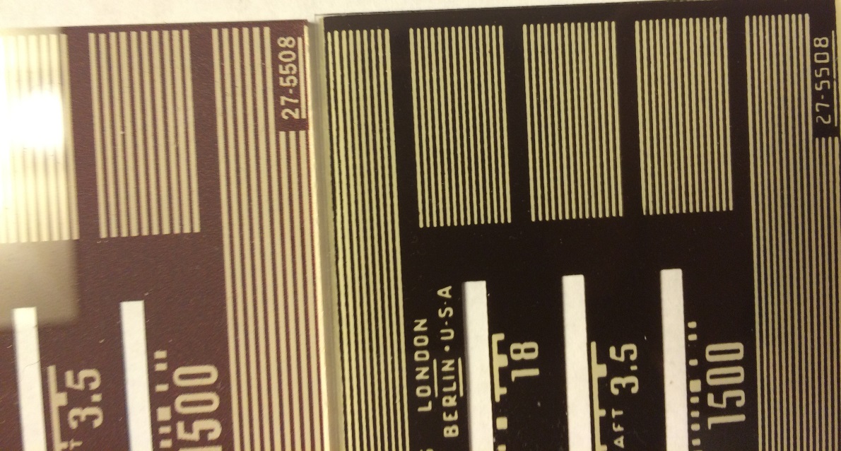

Part numbers are the same on the 40-180 dial.  In fact, I took pictures of them Specifically because the font on the part number was very "round" compared to the original "square" font.  Now granted, you never see this part, unless you have the chassis out or the bezel off.  But still, just one other area where the accuracy was low.
Here is a comparison of RD on the left, and Mark's on the right, of the lower right hand corner with the part number.

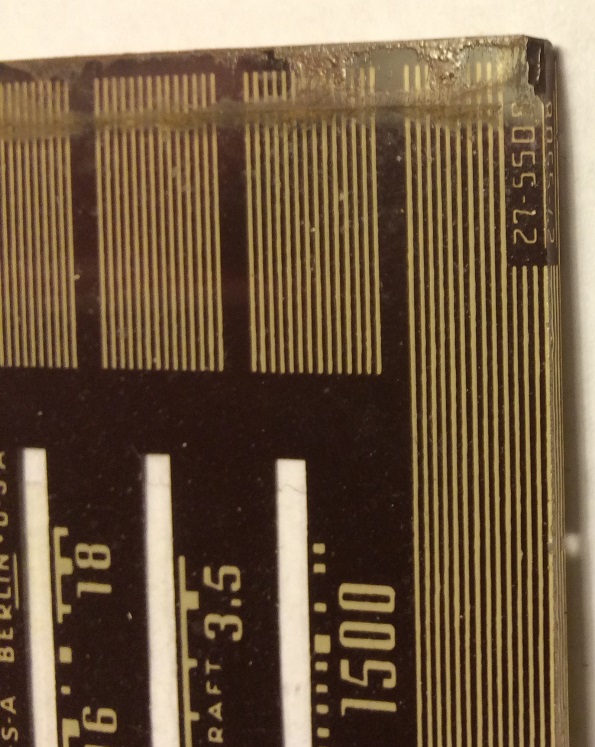

And for comparison, here is the same corner on the original.  Mark's font is almost identical here.
I bought this, probably some time in Aug - Oct of 2013.  Not sure if that aligns with when they were printing in house our outsourcing.  But if you look at the picture on their website currently, it's still got the thicker lines, wrong font in the corner, and in general, everything still looks too thick.  I also noticed now looking at my pictures again, the RD brown background is quite a bit lighter than the original too.  Mark's isn't perfect, its maybe a touch darker.  But still closer to the original color.  Although that could just be lighting or what not.  I would have to pull out the RD and original and compare (I currently have Mark's in the radio).
