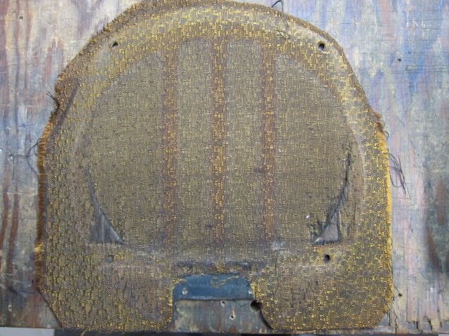

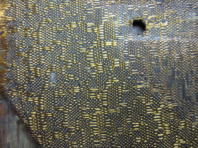

That pattern you are looking for was used on Crosleys and Zeniths as well. I think it was the old pattern 24. What was confusing to most was the assertion that it was an "aged" Philco pattern - but it matched the un-aged grill cloth of these other brands.
Borrowed from OLD GCHC site.
