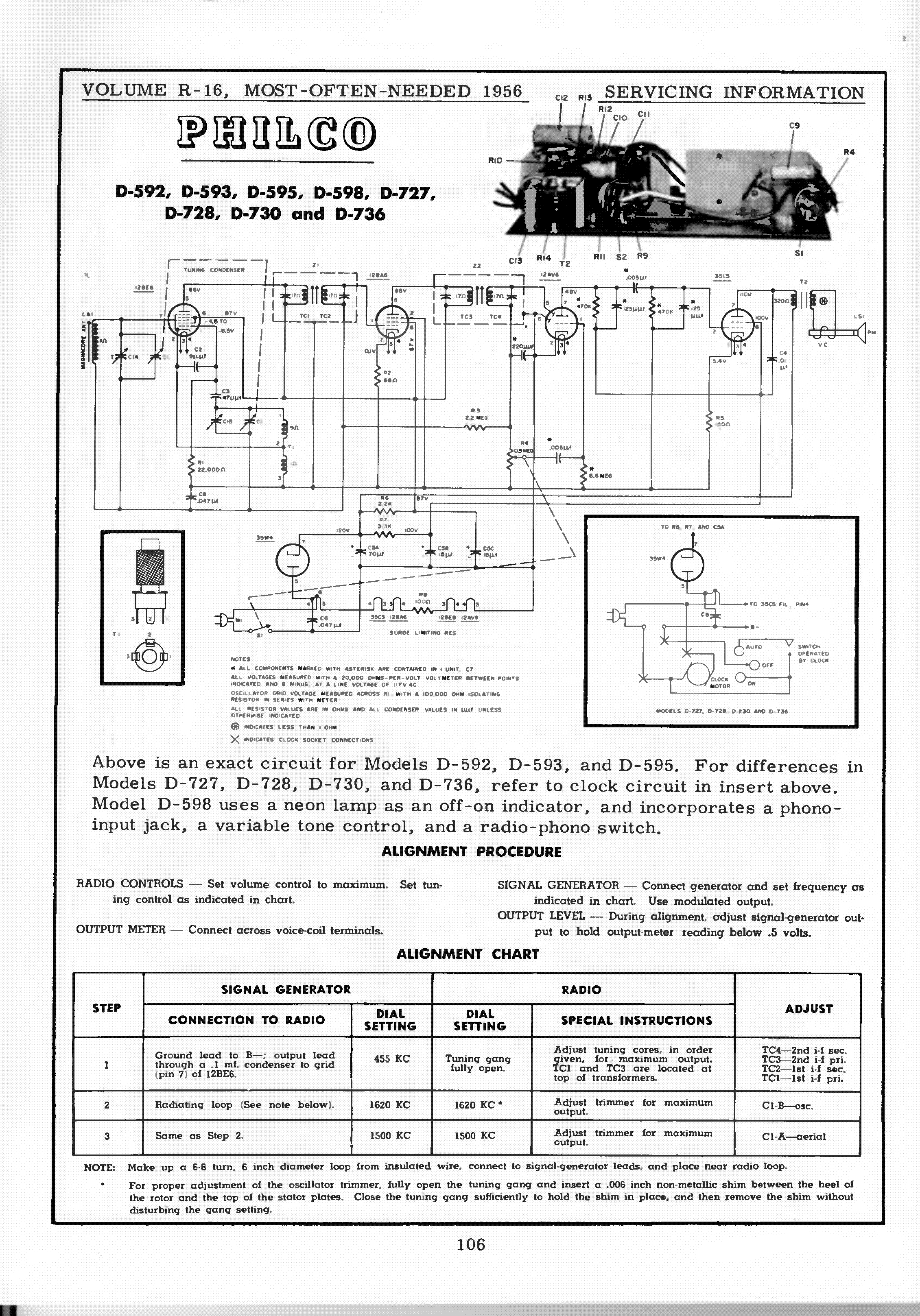

Mike will try and add Philco 730 some years ago I downloaded all of the Beitman files so if you ever need anything just let me know. David
Philco 54-6182-1 part number
12-28-2016, 10:00 AM
David
Thanks. Could you make it an attachment here so I could download? People who do not drink, do not smoke, do not eat red meat will one day feel really stupid lying there and dying from nothing.
12-28-2016, 10:25 AM
Very nice David....
AC: 4 DC: 1
12-28-2016, 10:50 AM
I also have Beitman, but the quality is not the same.
I printed the images that you put in here, they still came out nicer than what I had so far. Thanks. People who do not drink, do not smoke, do not eat red meat will one day feel really stupid lying there and dying from nothing.
12-28-2016, 12:41 PM
Mike My computer skills rot on a good day! If using windows 7 you can save image as a pdf by changing your print setting,when I tried to attach image as a jepg? file size was 1.1MB not allowed so had to use GIP image less than 500KB. I do not know how to convert DJview to PDF.The whole year of 1956 bietman is 7.65MB. David
12-28-2016, 12:59 PM
Will try and do all of 1956 as a zip file no luck will try and figure out how to convert to PDF. David
12-28-2016, 01:23 PM
mike

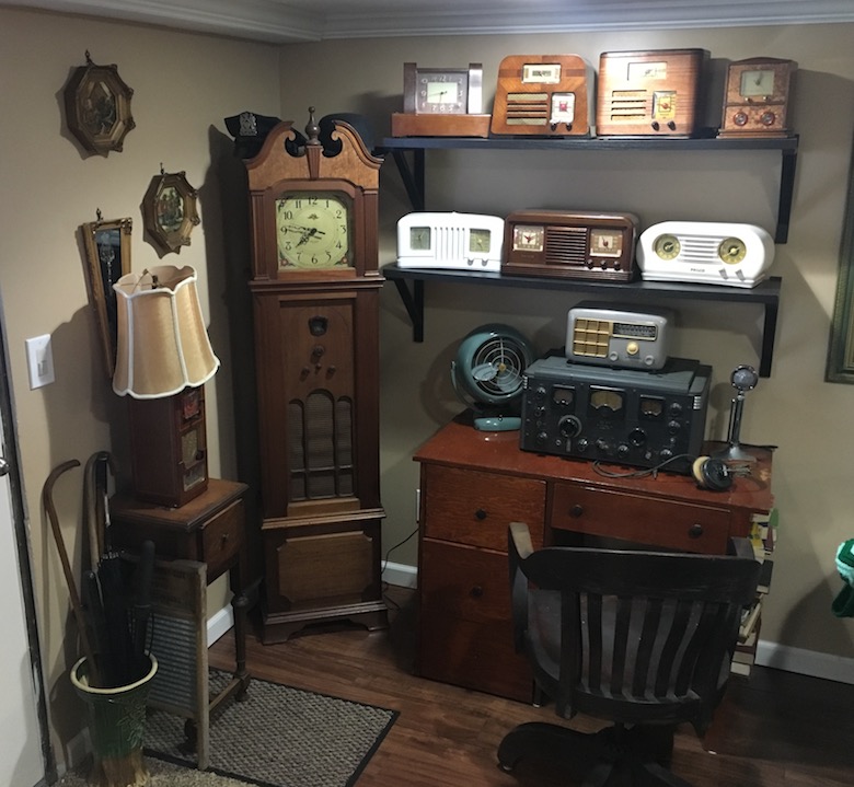

YOu can blame Sam.. He used it as Bribery to get a cabinet done, I cant wait to sell it on ebay... I mean display it It will go in my clock radio section of the den!! I will need to move the Halli's... I have 3 or 4 more clock radios in resto that will need to fit there too.... Thanks Mike and Sam! Times I have been electrocuted in 2021
AC: 4 DC: 1
12-30-2016, 03:41 PM
Nice clock section.
12-30-2016, 07:55 PM
Hey I know that top right one
Some day, and that day may never come, I will call upon you to do a service for me. But until that day, accept this justice as a gift mafiamen2
