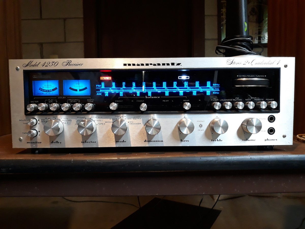

It's back home and now set up next to the workbench in the basement:
That dial certainly looks good with all LED lamps.

I should mention that it's been more than a month now...and the 4230 continues to work well by my workbench.
Thanks again Ed L. You did a great job on this tough dog Marantz.

the large flywheel tuning wheel, blue lite, very sexy.

That's a beautiful receiver Ron, I'm glad it's back in service!
