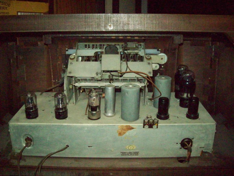

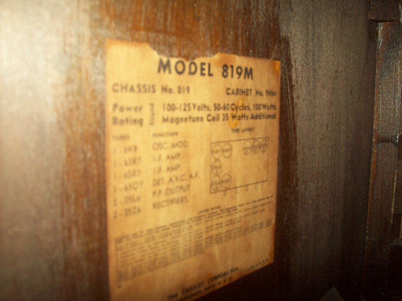

I've decided to start a separate subject about this radio as the more I look up about it, the stranger mine seems to be. It turns out most I am seeing have transformers and use two 5Y3 rectifiers where mine has two 25Z6's, though stick with the two 25L6 tubes. Mine definitely left the factory as a transformerless set, but I noticed the chassis is stamped and drilled for a transformer and (a bit of a nitpick of mine) Crosley went from two, to only one dial light which on mine is basically a night light bulb. The dial is stamped for two and they really should have used two. Also, it seems certain versions also had an internal antenna that could be adjusted from the front where mine only has a basic ground and antenna wire. Ok, what on earth did I pick up here?
It also appears that other than a new cord and alignment, this radio hasn't been touched under the chassis, yet it works like a champ, is clean inside, and the tubes are all good.

Riders shows both schematics on page Crosley 11-38.
http://www.nostalgiaair.org/Resources/632/M0003632.htm
I'd say you picked up the transformerless version of the 819M.

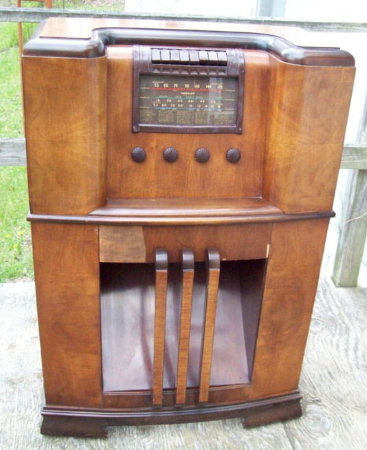

Nice find! I think that's one of the more handsome linear-dial consoles built!

After looking at the schematic I think I know why I passed on buying one of these, it was the fact that it was a console with a big cabinet, and a big chassis, without many tubes. If I'm not mistaken the two 25Z5s are connected as a voltage doubler, probably for full wave rectification rather then simply higher B+ voltage.
