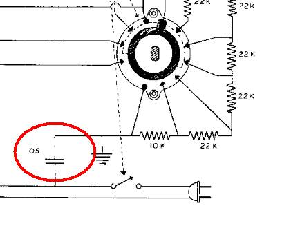

You can also try disconnecting one end of the .05 cap that is going to ground.

I disconnected the .05 cap that was from one side of AC to ground No difference..
