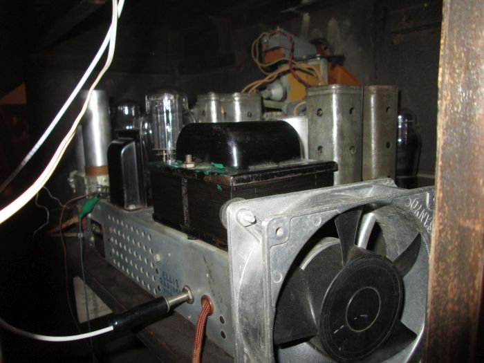

Mine run a bit warm too. If it keep it on for more than several hour the fan comes on. Line here is about 118v haven't used a bucking trans to lower the input voltage. Because of it's current @ 165w would need about 12v 2A transformer.
