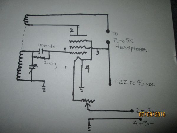

ID on this one tuber...?
Any thoughts on manufacturer and model for this one tube radio or tuner?
The one tube is a 32 and in this set its a Wards Airline 32 though that doesn't mean its a Wards Airline set.  The socket is engraved with 32 as well, so that's the right tube for the set.   One knob flips the back end of the two coils to align the coils, one turns what looks like a rheostat and the center knob turns the tuning cap.  On the back of the chassis is a two prong jack for "phone". Not much else to it.  The front has an Indian and a Covered Wagon design.

Very kwel!!! I would guess that it was a kit of some sort. It is regenerative, the knob one the left control the regeneration, center knob is the tuning and the the knob on the right adjust the filament voltage.
Not sure about the filament wiring as the pic doesn't show it well.

At first glace I thought that it may have been a short wave convertor of some sort, but since it is obviously battery operated, and has no provision for connecting it into the front end of another set, it must be a regenerative receiver, or perhaps a tuned RF amp of some kind.
Methinks the connector on the back that sez phone is the give away. If time was no object you could have a look at some magazines from that time period (1931-34) something like Shortwave Craft or Radio News. You maybe able to find an ad or short article on it. Unfortunately it's a very common circuit from back in those days.
