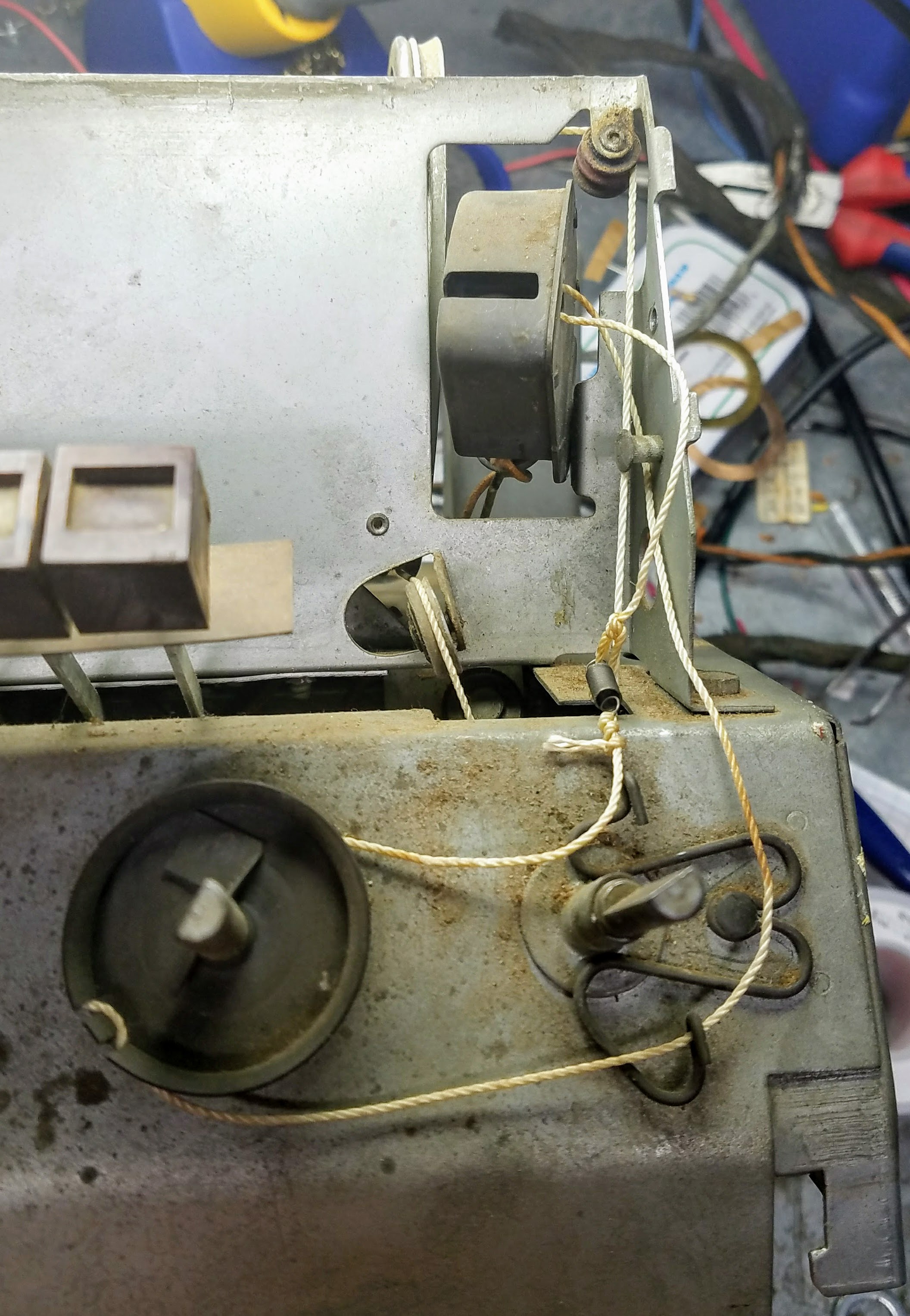

I popped off the band light cord before I saw how it was routed on the radio I'm working on. I can't seem to find any images or diagrams showing how this is routed. Can anyone help with a more detailed picture or diagram on how this is routed would be greatly appreciated.

I got my schematics from the above resource, and it has the dial cord routing, but alas, is silent on the band selector light. I think what I may do is instead just use some LEDs to light up the band indicators, since I'm going to convert all of the lights on this radio to LED anyway since the wiring on the existing incandescents is in such poor shape anyway.
