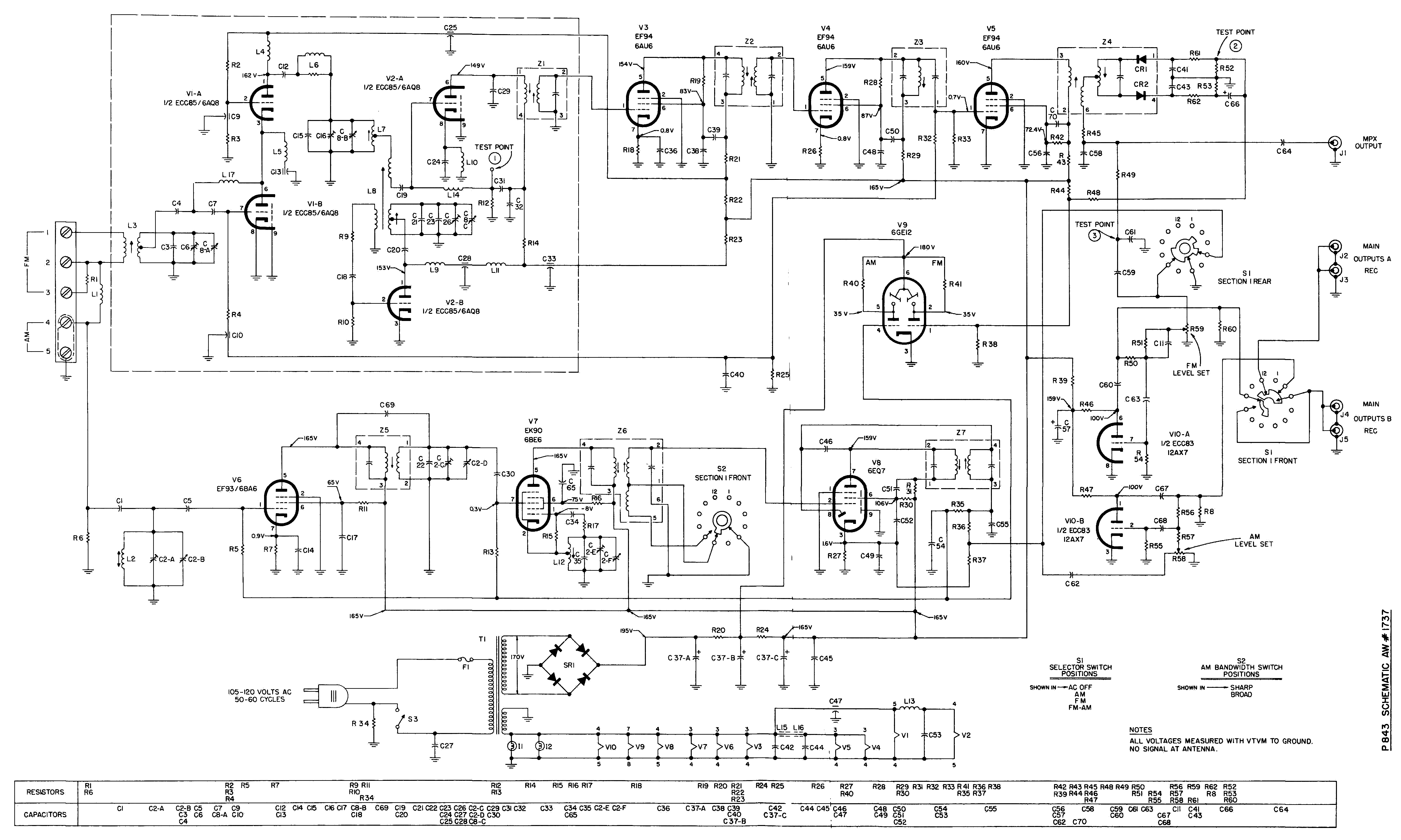

I'll post a schematic later. Edit: Here it is (warning - large file - 2.2 MB):
http://www.philcoradio.com/images/phorum...R/100R.jpg
