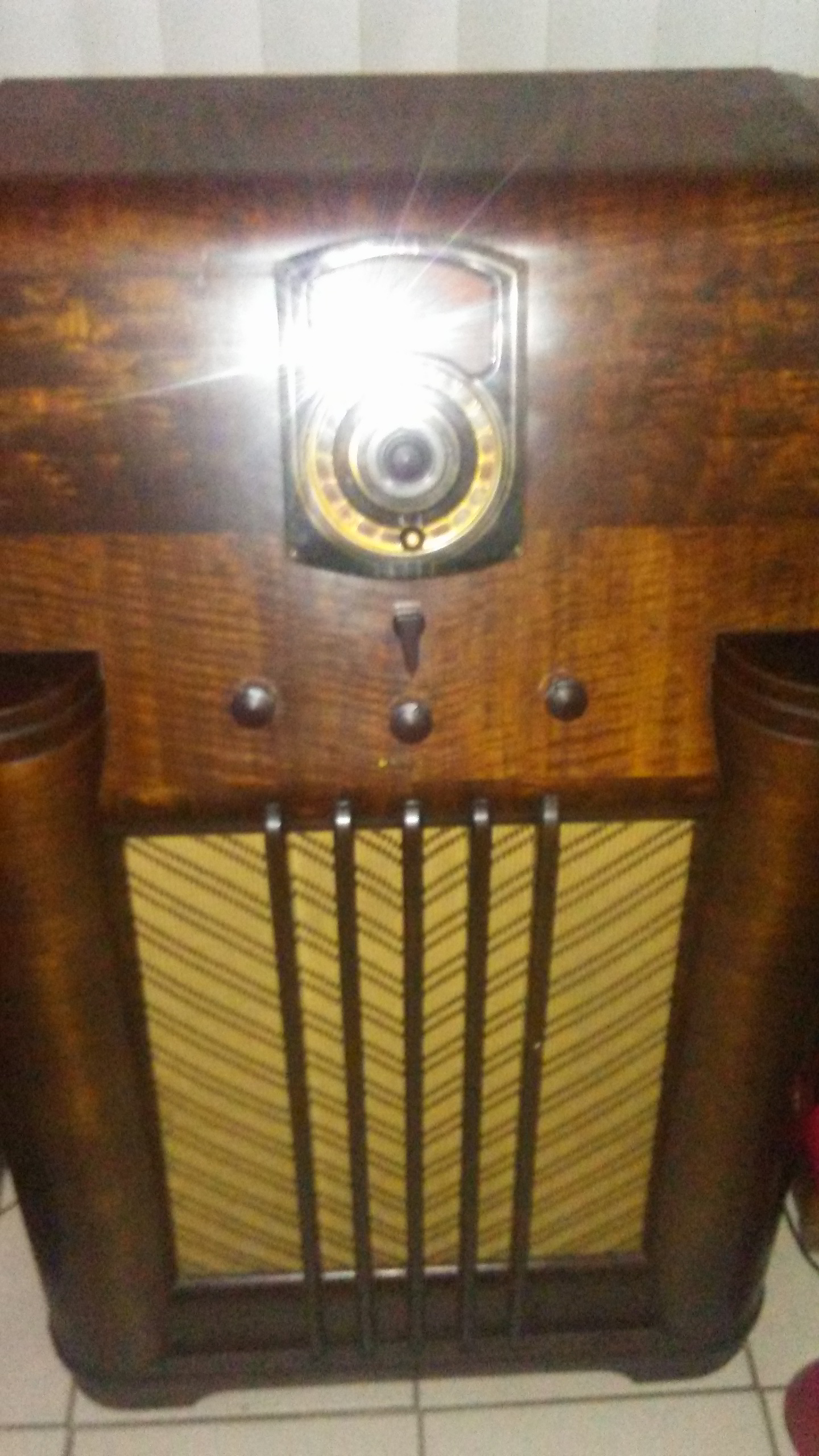

03-02-2018, 05:45 PM
Here is the result of hours and hours and hours of burdensome cloth application. I got physically ill from doing this...
03-02-2018, 06:53 PM
Thank you Ron! I think I got the pattern as close and evenly spaced on the board as I could, especially the section of pattern in the middle- even now, I can tweak it close to perfection in the center rungs, but the outer edges need to be dropped just a smidgen. I said I pulled the fabric up completely twice, with hundreds of mini adjustments which consisted of pulling the cloth up and out in spots. The Chevron pattern was giving a strange effect on my eyes after awhile, kind of like those "magic eye" posters. After several days of fooling with it, I got quite ill and needed a whole day to recuperate from the exhausting experience... I'll not be doing another one of those for a long while...
03-04-2018, 12:46 PM
Looks good!!!
I too have several radios here, with original grille cloth, that have the pattern slightly crooked or off center. As Ron said, most radios were built fast on an assembly line, and went out the door with what were considered "acceptable imperfections".
03-04-2018, 01:35 PM
Looks Fantastic !!!!!!
03-04-2018, 02:51 PM
Thanks so much guys! It's hard to tell from the image, but all of the Chevron lines wind up exactly even at the corners and in the center rungs. That was the most difficult part of all. Right now I could pull it again and realign it, but that will have to wait for round two... In about 10 years! I can live with it for now...
