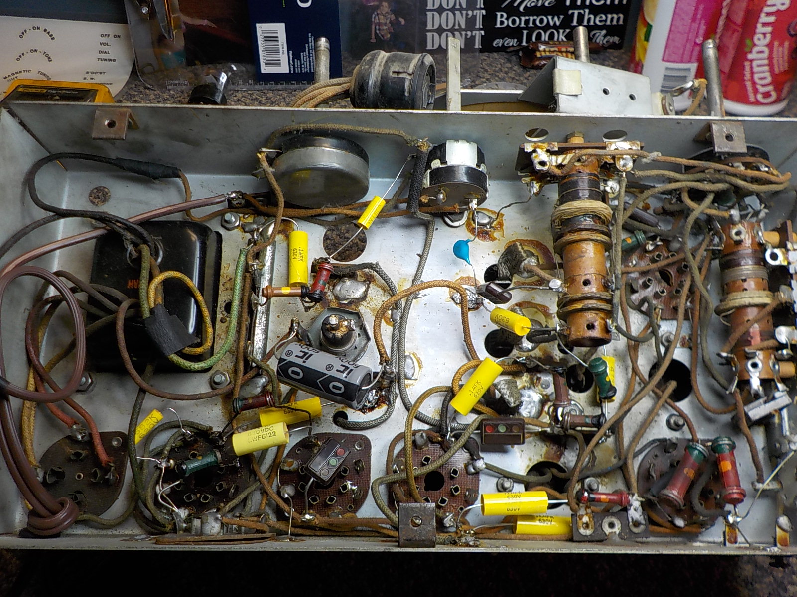

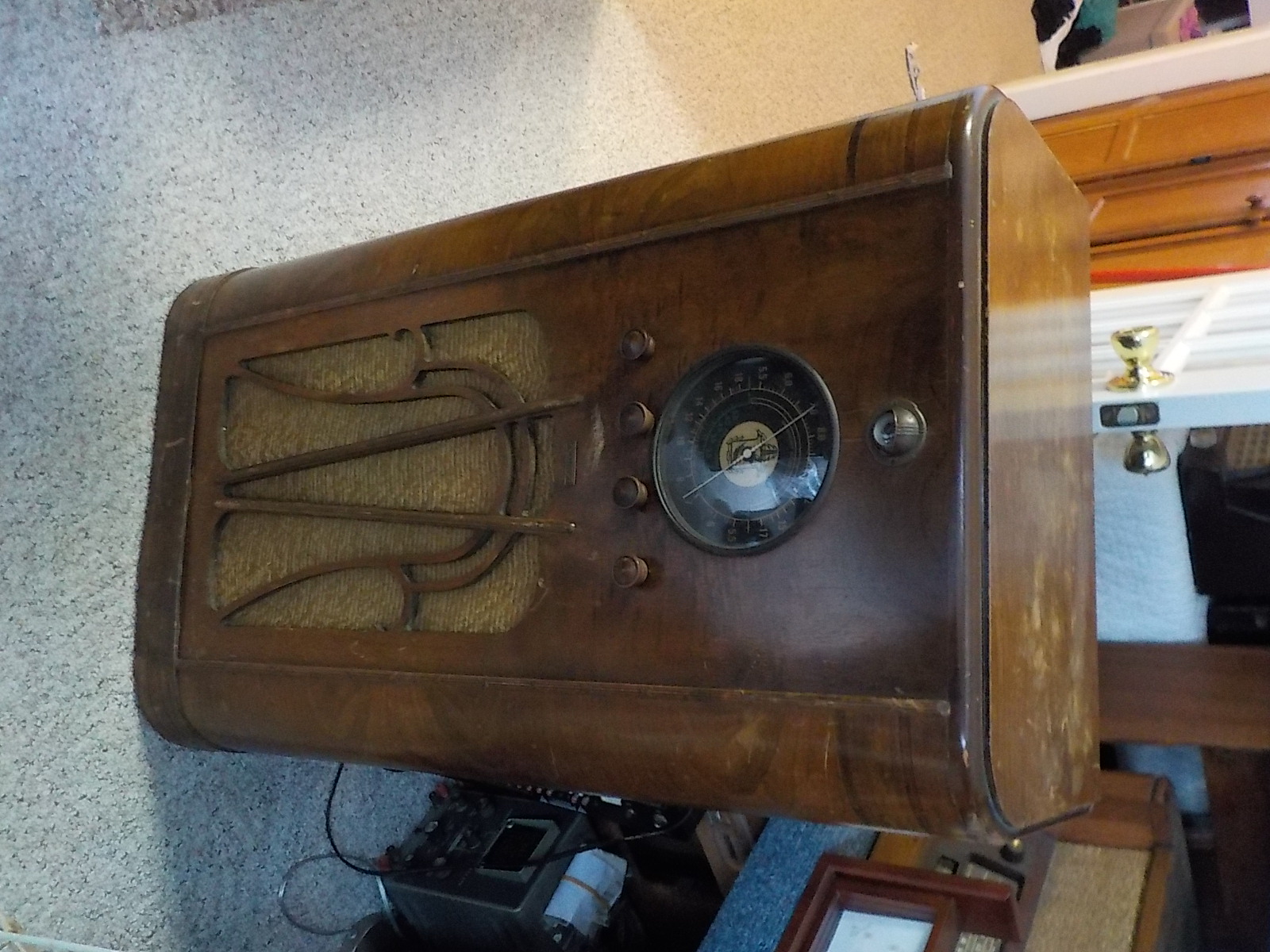

I often take a break from the internet in January (some may have observed this in the past), but I have spent some time in the radio room. A few years ago I scored a Parker McCrory (Parmak) console from a local antique store. I liked the looks of it due to the large dial and eye tube. We had it in out living room and I got tired of people asking 'Does it work?" So, I flopped it up on the bench and started some checks. The initial tests revealed the power trans and speaker field may be ok. Open primary on the output transformer. Next I tested the tubes. I found a weak IF tube (6K7) and a dead 6F5 and 6E5. All others tested good, even the 80! I started the recap. It seems to have gone well overall. You can see that I decided to use discrete e-cap instead of messing with restuffing. I connected to the output transformer on the signal tracer for testing purposes.
Upon a slow power up, I was amazed to find it was picking up stations! It wasn't real strong, but showed me that everything was working. I started doing some fine tuning (not the alignment) and here was what I have found: Upon powering up it would sometimes make shrieking and popping noises. I noted that it had an (undersized) universal output transformer. It had been replaced at some point. It went dead on the 3rd power up, some some quick observations noted the tuning eye tube was showing it was tuning in stations. Ok, onward. A finger test on the 6F5 grid cap produced nothing. I poke with a meter probe on the 6F6 grid produced a hum. The 6F5 died, so I rummaged around and found a fairly decent replacement. This brought the radio back to life. I suspect this is what killed the output transformer, and probably the one prior. It plays fairly well, but is weak on volume. Tuning seems sensitive. This may be due to the mismatched output test transformer.
Now, I havent been able to find any schematic in riders for this, so I dont know if this was an odd one run make or was bought out by another company. The model number is 105212 as far as I can tell. I am having to use my instincts on this one, but any help would be appreciated as far as a diagram, experience, or history.
The 6F6G output tube appears to need a transformer with a 7000 ohm or so plate load according to the RCA tube manual. Judging from the size of the speaker (about 12"), I am guessing the trans to need to be about a 5w. It has around 200v on the plate. I have no idea what the impedence of the speaker is. It does work, but again, very weak.

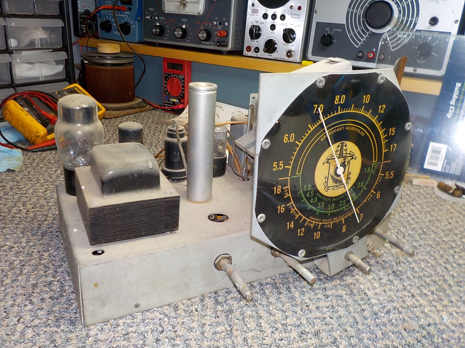

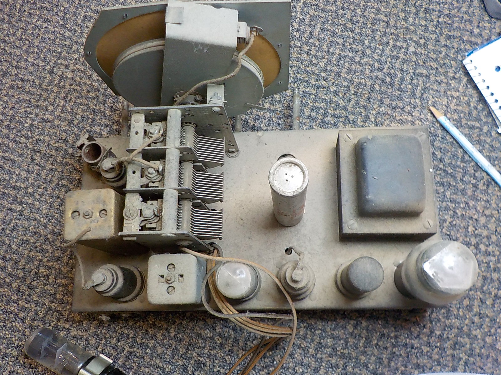

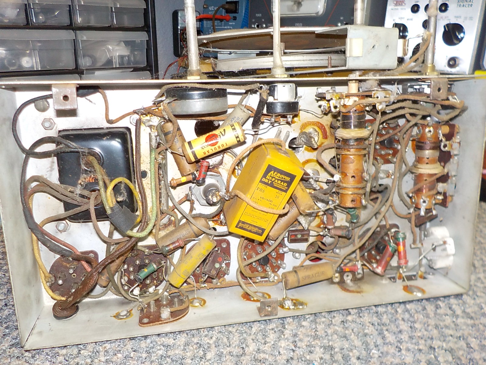

Here are a few pictures of things before I started the recap:
More to come...

More observations and pictures: It appears that this has had quite a bit of repair work done in the past, even up to a full recap. Most of the caps I removed were Spragues. I also suspect the tuning eye tube may have been added, since it uses a 6E5, rather than the older 6U5. Could have been modded to accept the newer tube, but I can't tell for sure. It does look like it was fairly decent repair work previously.

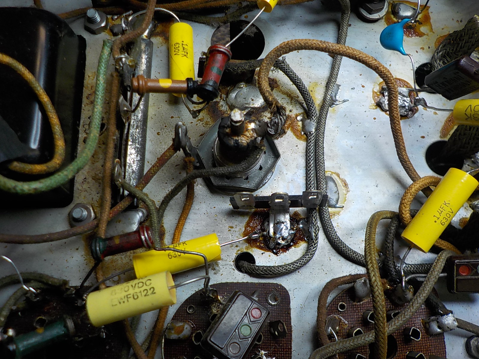

I do have a few issues and questions. It only had one electrolytic cap coming off the cathode of the 80. No others. The neg from the original can is not grounded and has (I believe) a negative voltage to chassis ground. The old replacement had the negative going to a tap on the bias candohm resistor instead of across the original. I connected the new cap across the original (of course, removing the old cap from the circuit). It had a little hum, so I tried it the way the replacement was in. It made the hum a lot worse, so I returned it to the original position. I suspect the hum may be due to not using the hum bucking coil on the original speaker.
I also noted the power transformer had been replaced. The eye tube brightness will flicker when the volume is turned up, to the tune of whatever is being played. When it is turned down, it is normal. The B+ jumps around when the volume is up. May be the wrong output trans? Or, the wrong power trans? I tried adding another electrolytic in parallel. No change. I am using a 10mf cap (original was 12, and the old replacement was 16).

Below is a close up of the power supply area. You can see the stub of the replacement e-cap wire from a previous repair on the candohm. 2nd lug from the top. I left that to remember where it had been in case I needed to move the new cap neg to that point.

I had a look through the Parker-McCrory schematics listed on Nostalgia Air, and the vast majority seem to be battery sets, either full blown ones with "A" and "B" batteries, or vibrator supply types, there were a few AC sets but those seemed to be newer and with pushbuttons. I'm wondering if Parker-McCrory was the manufacturer, the chassis construction and dial design kind of remind me a Musicaire radio I have built by Sentinel? I'm also wondering if this may have originally been a 6 volt operated vibrator set at one time, except that I'm sure there would be more evidence of that such as marks where the tin box containing it all was located. If it was converted it was done a long time ago, the power cord is made out of natural rubber. I can see what you mean about the eye tube, the way that they routed that cable looks amateurish, it's unlikely that a factory would have routed the wires through the same hole as the grounding strap for the tuning condenser, all the other eye tube equipped sets I've seen had the cable routed through a 1/2'' hole usually lined with a brass grommet.

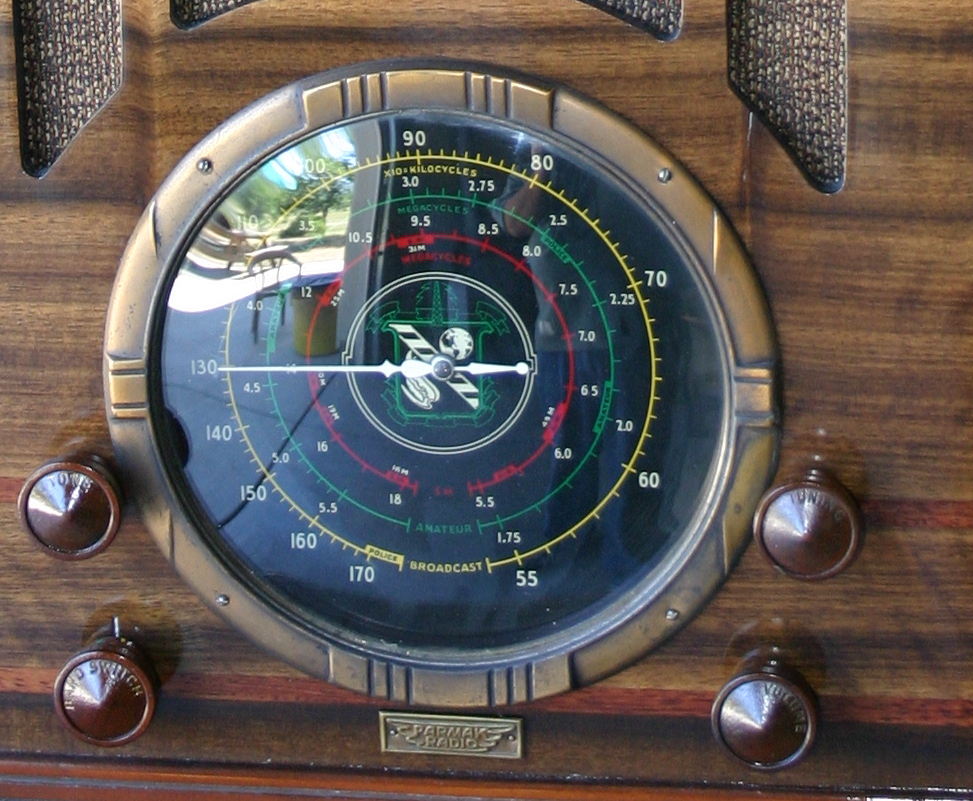

That is a Parker dial, like this one.
More pictures (2nd one down):
https://www.russoldradios.com/unique-radios.html
Parker made some very nice "farm" radios.
