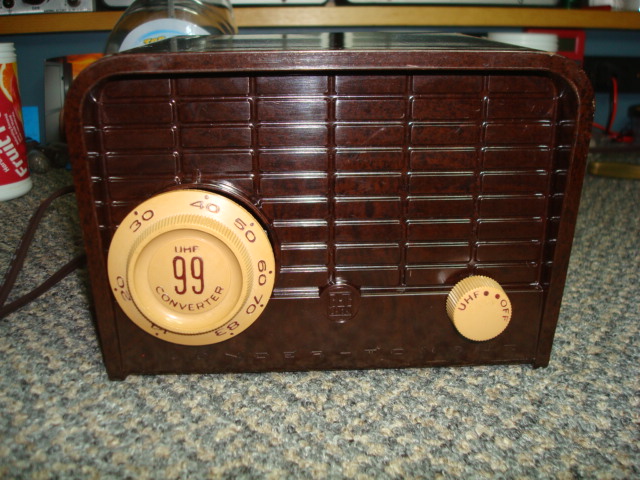

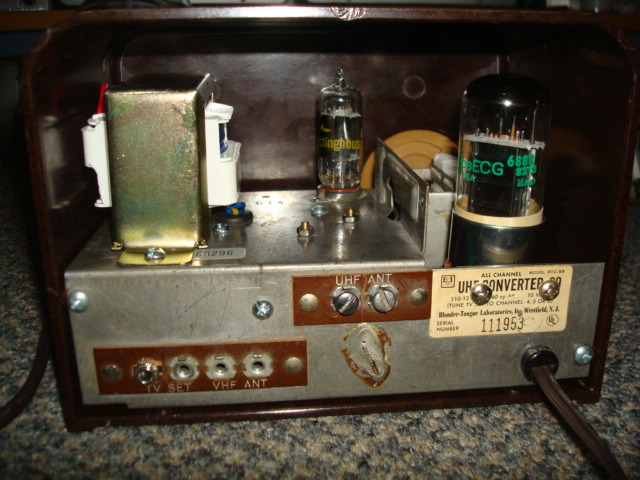

Here is the finished product. I still will do some refining, but it is working.
Tim

looks great tim
so when does production start
sam
