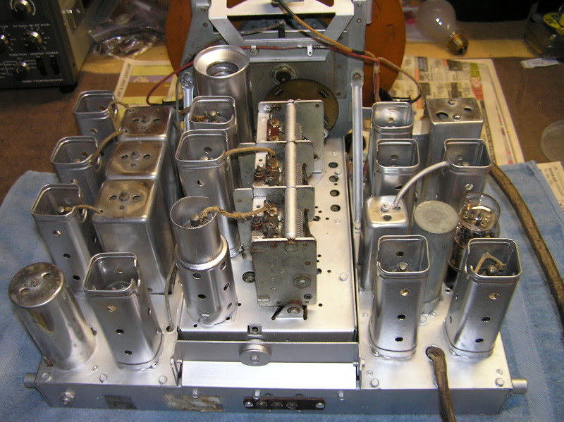

I haven't been doing much radio work lately. But I just thought I would let you know I restored my 38-690 in the spring of 2016. I used all film caps. I restuffed electrolytic cans and all paper caps. I used a combination of Solen 10uf/630v film caps and some 2.2uf/450v Panasonic film caps Mouser p/n 667-ECW-FD2W225K. Also used a few 10uf/63v film caps Mouser p/n 505-MKS4C051005FKH00 to complete the job.
Here are a few pics of how it turned out.
[Image: https://lh3.googleusercontent.com/37sk-q...i3RV=w2400]
[Image: https://lh3.googleusercontent.com/Q7WbD2...bbJ4=w2400]
[Image: https://lh3.googleusercontent.com/ej_qsa...j-4s=w2400]
[Image: https://lh3.googleusercontent.com/qYrNza...W2VC=w2400]
I hope this helps.
