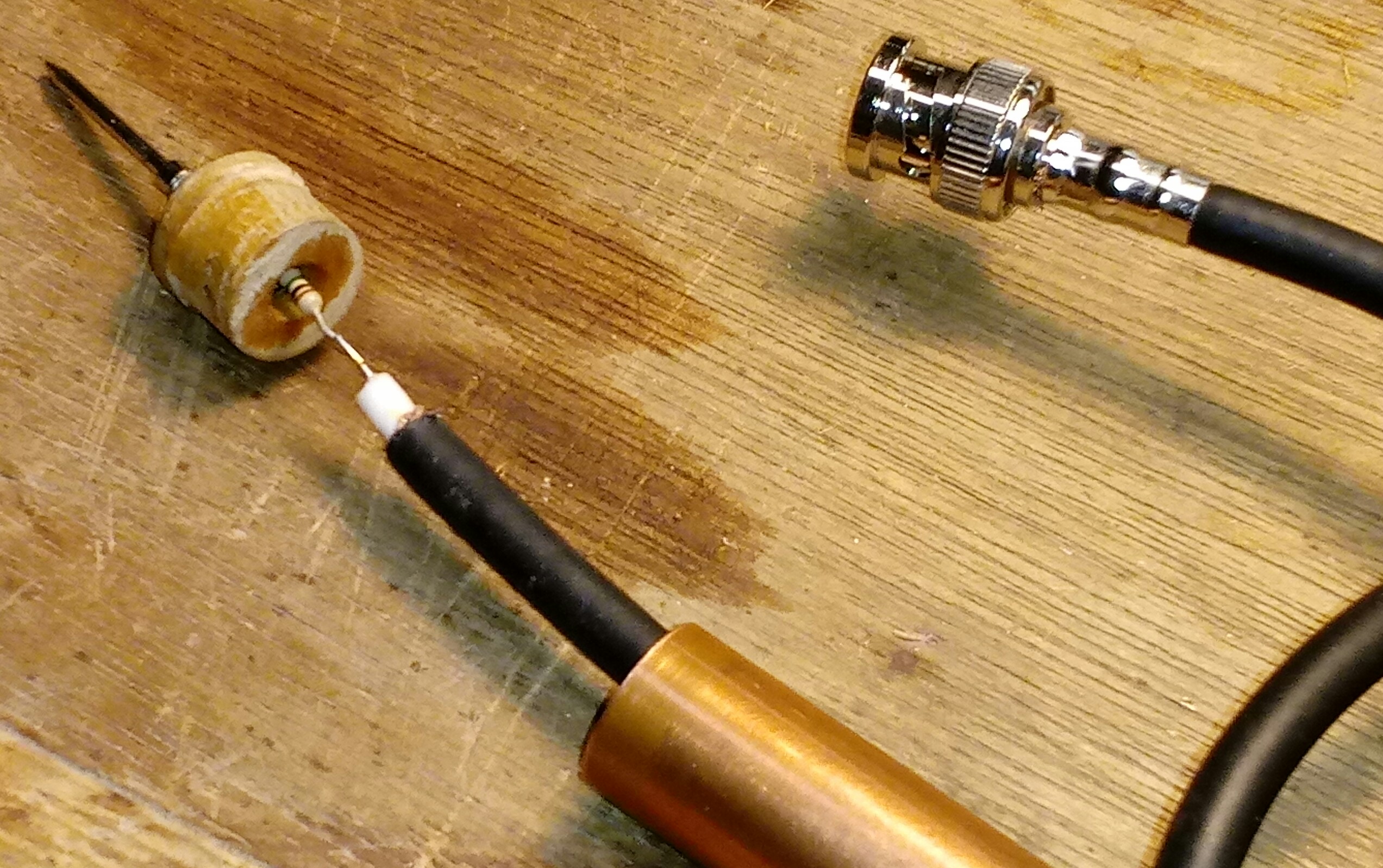

On my Heathkit V7, I replaced the DC connector to a BNC which made easier to connect to probes and test leads. Lately I just use a DMM since the input impedance of even the cheap ones are 1 meg or better. However, analog meters are easier to spot the max deflection than a bunch of moving digits.
As you may know the DC probe has a 1meg resistor in it. Is not just a solid connection from meter to probe.
Boy did I forget! Had to open one I made for the V7 a few years ago  and there it is, a 1 meg resistor soldered to the tip.
