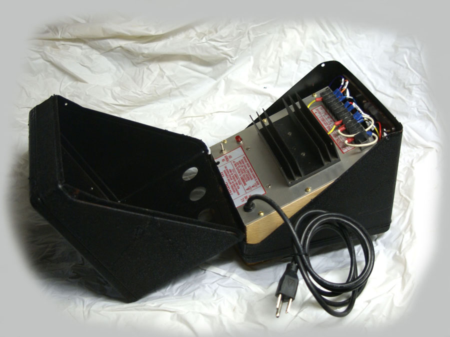

It may be sacrilege but I gutted a Socket Power B and managed to fit a an ARBE III into the case. I had to remove the plastic ARBE case and install some angled wood supports. With the Socket Power cover opened I can attach all of the necessary voltages to the front panel. I had to add one pair of terminals for the detector voltage and I brought them out to the pair of (now) unused holes on the bottom right of the front panel.
