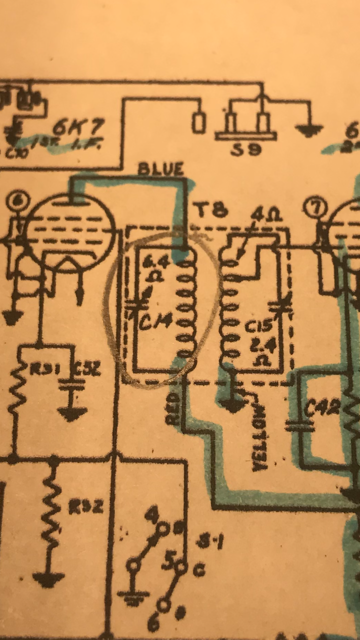

I believe I have found one of my problems (circled part) Instead of the 6.4 ohms, I'm measuring 22k... in the 1st IF can, Im not sure how to go about correcting that yet. I've decided to trace every wire back on the print and check every resistor along the way, I,ve found a few pretty far out of spec but not sure if that would cause my problem. But im certain that IF would. Any suggestions on repairing are welcome. TIA
Ryan
#24
If winding in IF transformer is open generally they require replacement, though sometimes brak is visible and can be repaired.
Tom
#25
Most likely than not the winding is open.
It is worth opening the can and seeing if it could be repaired before embarking on a search for a spare IF can.

After a 2 week break away from the radio with family matters, im back on it, I found the break and I took a couple wraps off the IF transformer that was reading open. Im now reading 7.4 ohms through the transformer instead of 6.4 ohms, hopefully this wont effect it much?

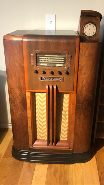

    Finished.. I had to use some darker toners due to heavy stains on the top and chipped veneer repair.
Ryan
