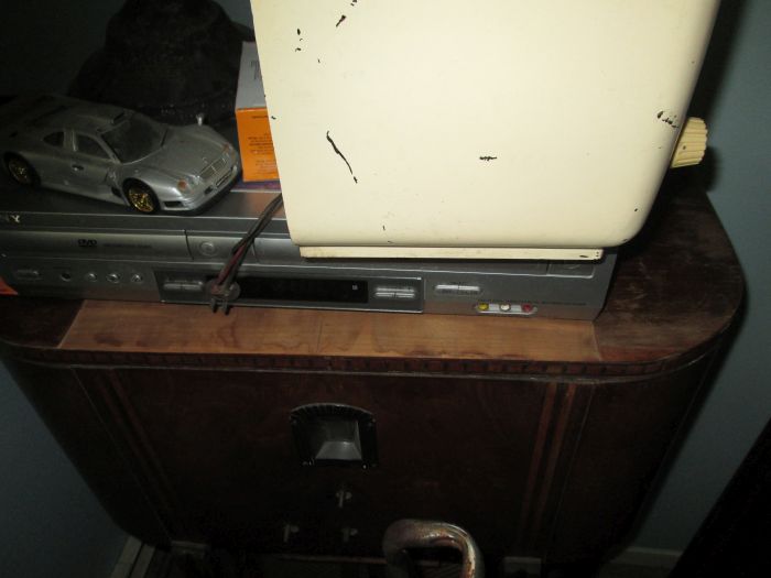

I have a 200X that the top is missing the center section of veneer. Anyone have a pic or know what the grain orientation is for this section?

Not so much the 200X has no inlay on the top nor is the edge routed. The inlay is on the edges.

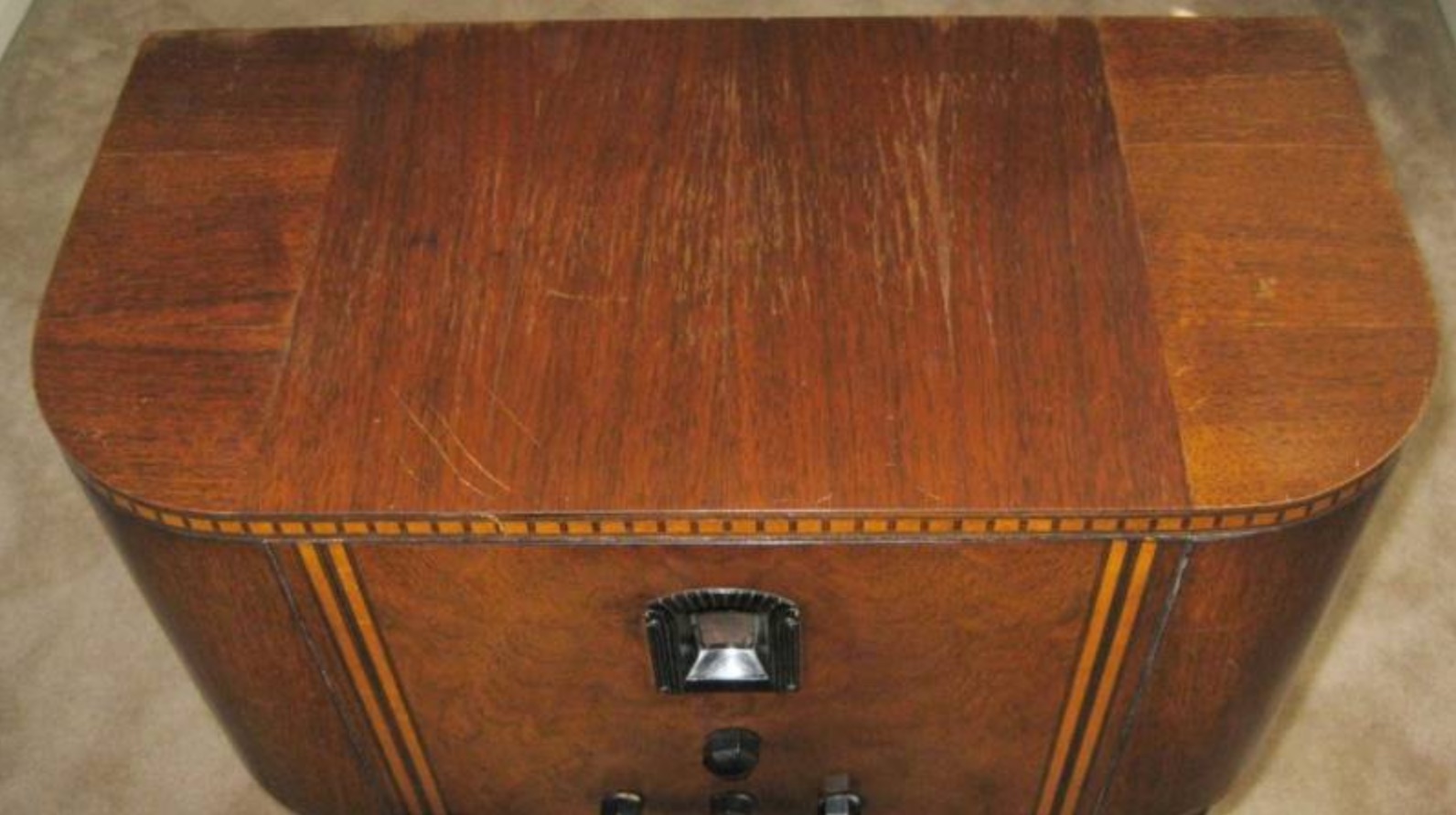

Here you go!
Source: https://www.radiomuseum.org/r/philco_200x.html
Tnx Much!
Though it would face front to back but wasn't sure.
