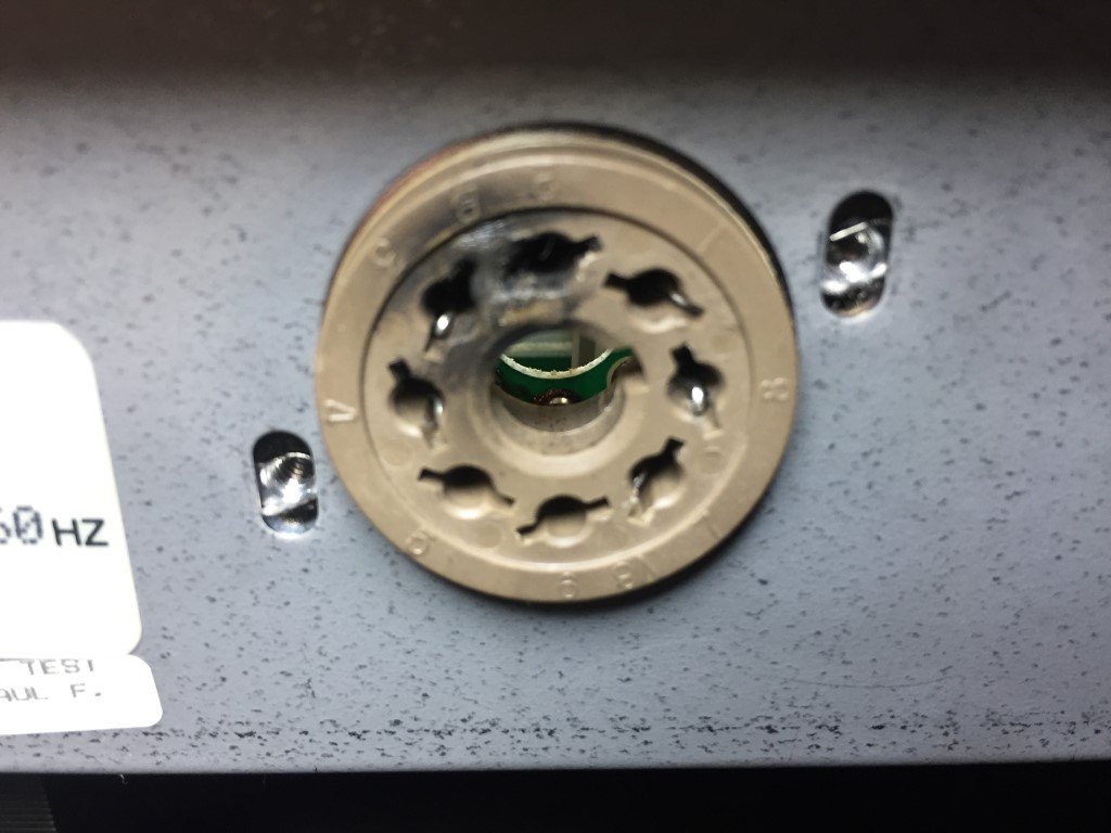

I'm into a mid 1990's tube guitar amp that failed a 6CA7 output by developing a carbon path between the plate pin and heater pin. Tube tested short, and found the burn marks on the tube socket and later tube when I went to replace. So, tube sockets on the way and a pair of Mullard outputs in hand. Now, my question - this uses "modern" electrolytics in the power supply. They are more than 20 years old. No signs of overheating. Should those be replaced as a preventive or left as long as things look and work ok? I dont want a repeat.

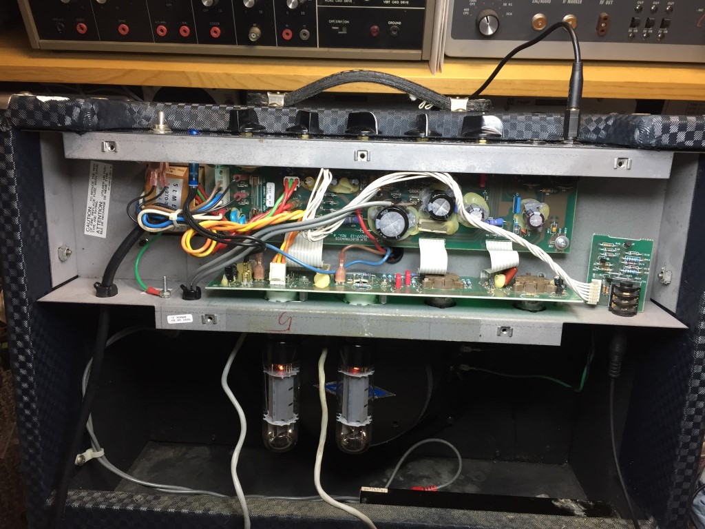

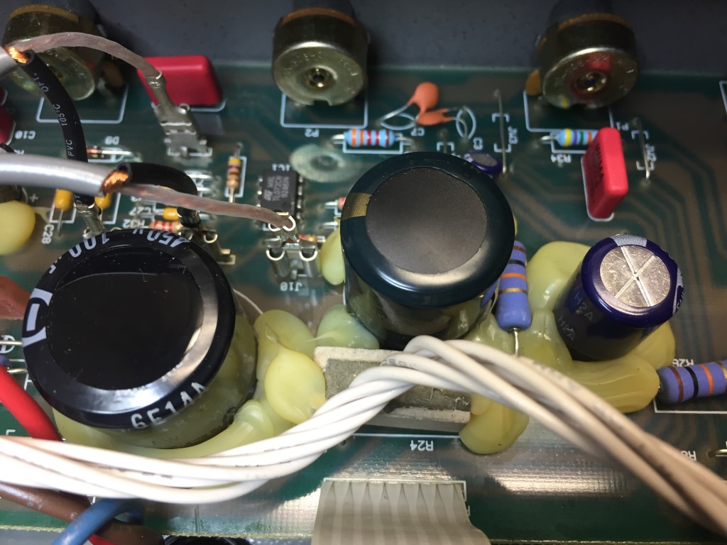

Kinda thinking the same. Its not something that is going to get a lot of use. Here's a couple pics of things.

Condensers are not that expensive. Were it I, I would replace the filter condensers as a preventative measure, if they will fit, with ones of a higher voltage rating.

I can't see what brand those are, but if they are from a quality manufacturer I would consider leaving them, otherwise I'd replace them with a known quality brand from a vendor like Mouser. A.E.S. carries Solen 630V Metalized Polypropylene that I often like to use in place of electrolytic caps but they don't seem to carry radial leads or values above 47 uf.

If they are Nichicon or Panasonic, or possibly United Chemicon and there is no hum, then you might chance leaving them. Any other brand, then replace - with Nichicon, Panasonic or United Chemicon (in that order with Nichicon being the preferred brand). Relatively cheap insurance.

Samwha caps. Sounds Japan to me.
Tim
Samwho?
Never heard of that brand. Replace...Nichicon is your friend. Or Panasonic.

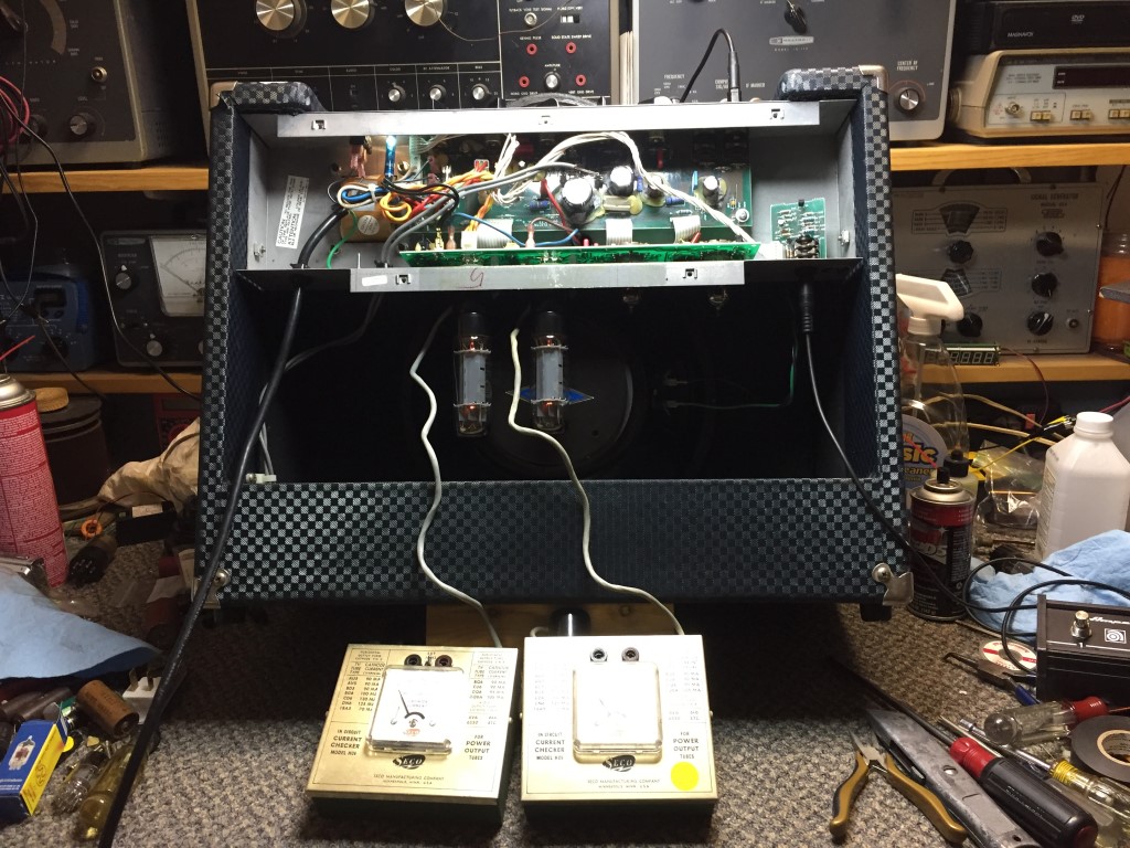

I finally had a chance to update. I replaced all the power HV supply caps with the good Nichicon brand from Mouser. I didnt replace any of the lower voltage caps, but I may need to. I put new ceramic tube sockets in, which was fun since they were soldered between the PC board and bottom of the tube socket instead of opposite sides. I installed a new pair of matched Mullard output tubes and bias looks about right (-33V if I recall). Im not sure just how well they are matched tho. There is a slight difference in cathode current when I monitor, but is small. They both draw slightly either side of 50ma at idle. I cleaned all the controls and fixed the speaker terminal connector after it broke off when disconnecting. I have a couple minor issues, which one I believe is the 12AX7A preamp tubes. I have some static, hissing or whatever when I first power up, but diminishes once it warms up for a few minutes. I plugged a new short plate JJ tube (only had 1) in and it helped quite a bit, but still had some noise. It is very quiet with the 1st preamp tube pulled and the JJ tube in the 2nd tube/splitter. It is noiser with the original tube, so I have a new set of Tung Sol tubes coming. Ill see if this silences it.

I pronounce it fixed. I replaced the rest of the e caps, put back together and found some of the cracking static came back until it warmed up. I pulled both boards and resoldered a bunch of suspicious looking connections. I put back together kinda loose to be able to flex things and pull again and had no sound at all! Huh ... so after some messing around I found flexing the board made the sound (and static) come and go and could see the output tubes flash inside (not sparking, you know -the look inside when the tubes are handling current). Well, I discovered the outputs were grounded through the screws and stand-offs that hold the octal tube sockets to the metal chassis! So, I went back and cleaned and tightened those screws very tight - quiet as a church mouse! So, if anyone has one of these amps with static/cracking noises and cleaning controls and replacing tubes doesnt completely quiet it, clean those studs or solder a ground to those to chassis ground. I still have a very light, low level hum, but I think it is the nature of the beast for the most part. It's not really HiFi, so it may not be completely quiet like a Fisher or Dyna.
