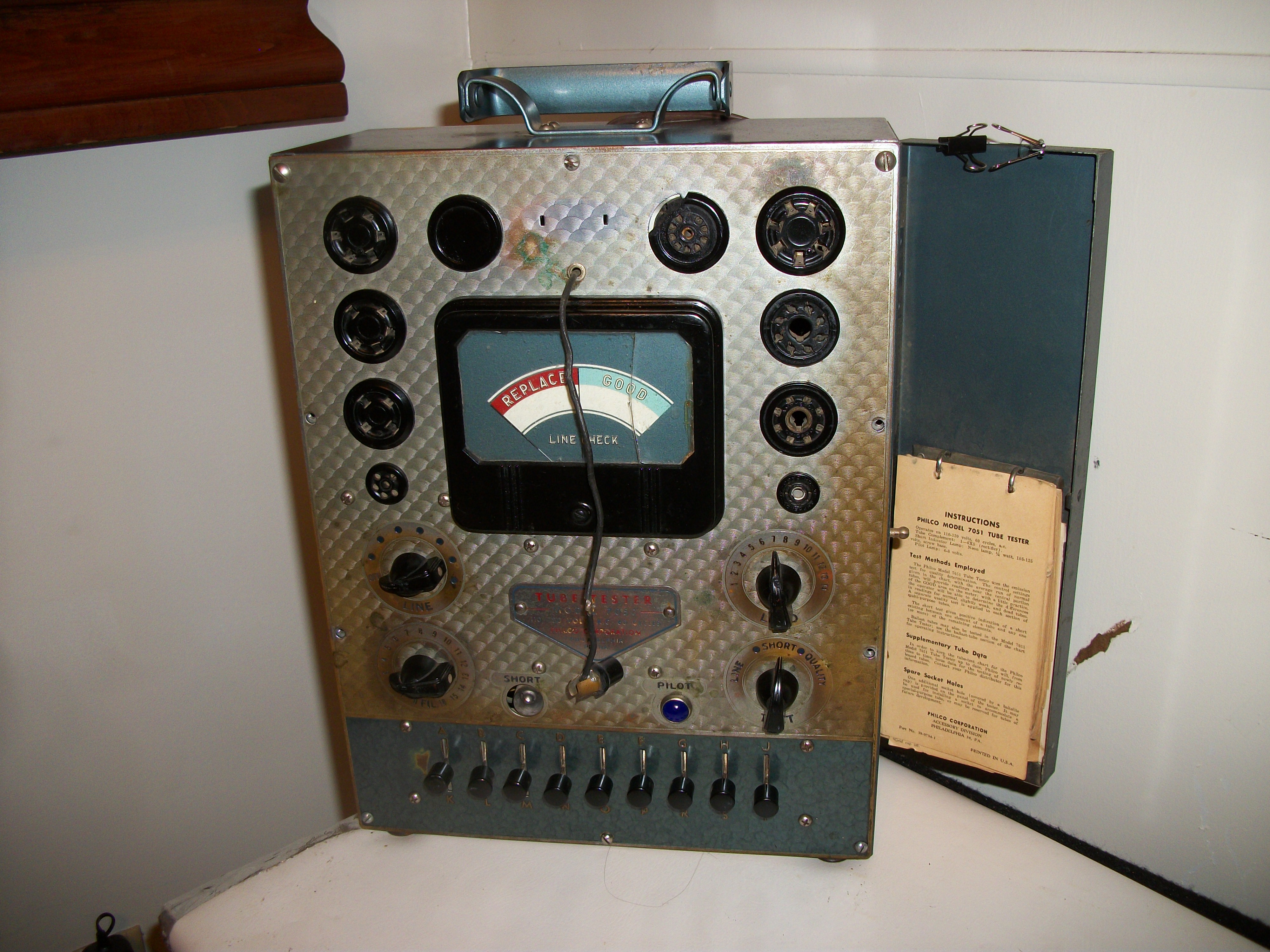

Philco 7050 tube tester
Got this yesterday, This is how it gets when
you have done a lot of work.
But guess what, it wants to do more.
Went over it (vary clean inside) seems good and
is working.
I have to put in a new glass but can you
tell me where to find a blue oval Philco
button. It would make it complete again
I think the only place you will be able to get one of those blue Philco emblems is off of another 7051. Hopefully your Wanted Ad will generate one, if not, perhaps the upcoming Kutztown event in May might have one at one of the booths.

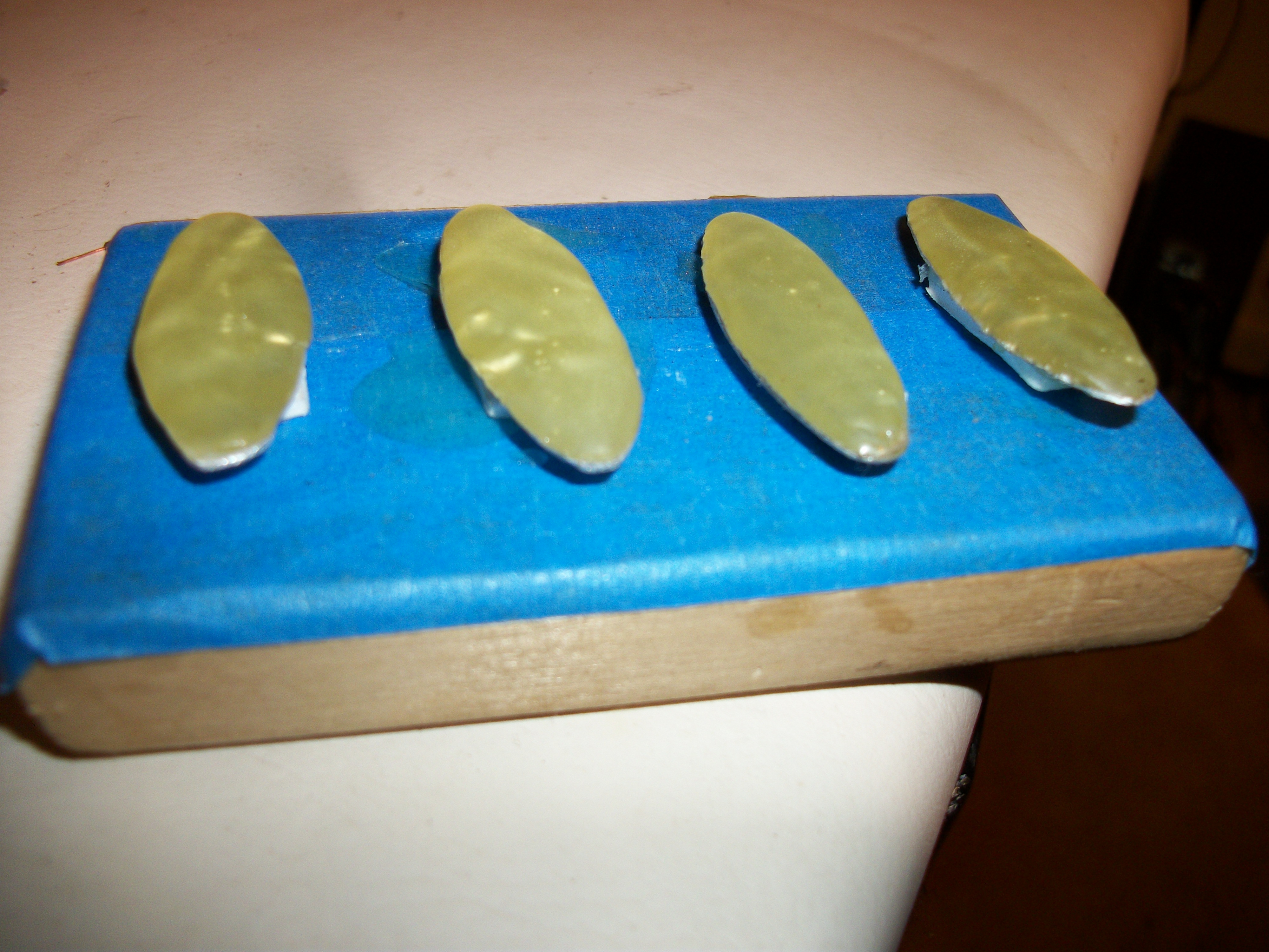

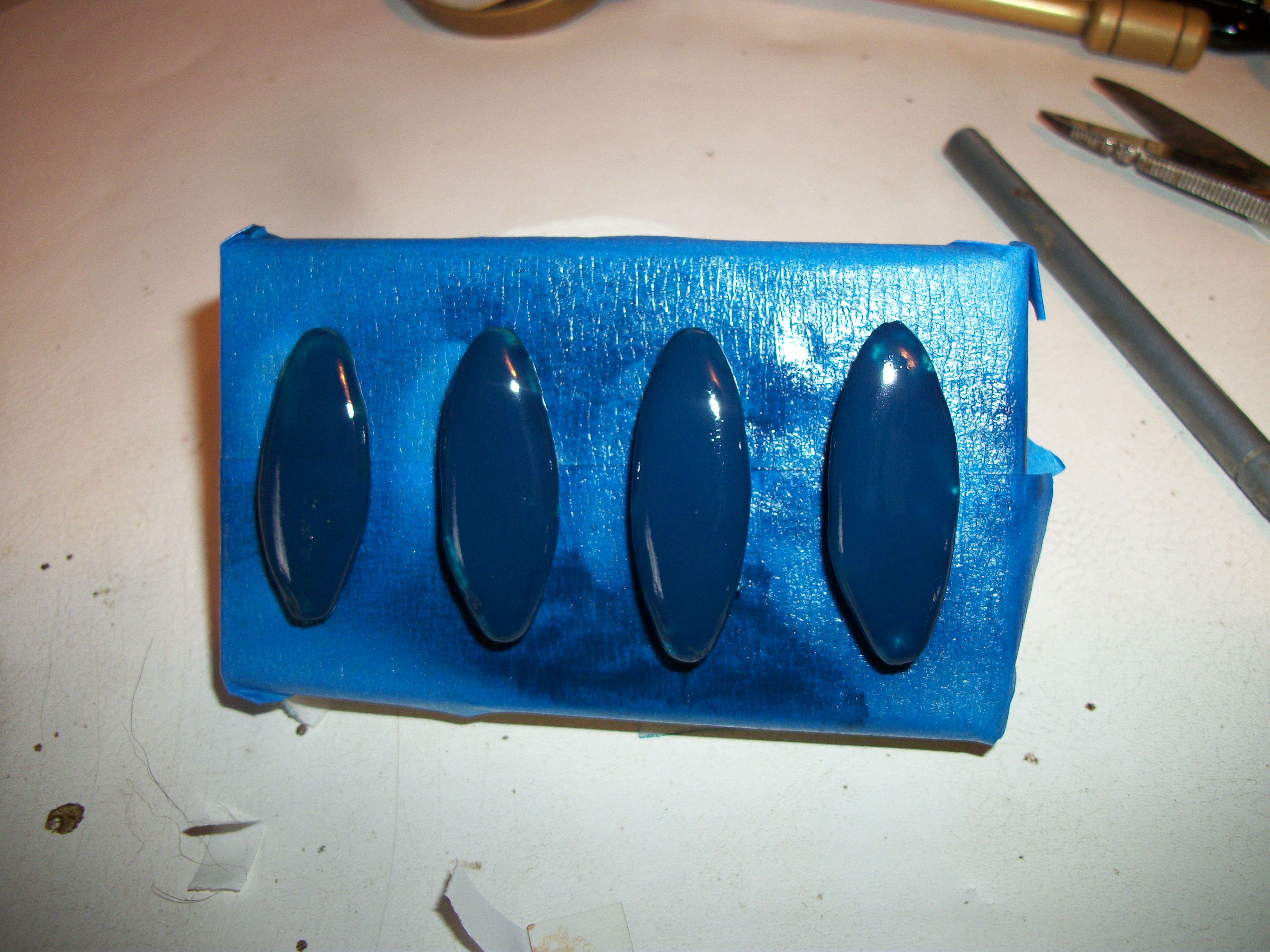

I have made the four buttons out of epoxy resin and painted them the same blue.
