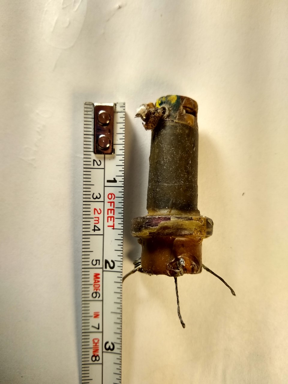

Here is a photo. There was a paper band around the primary, which I removed so that I could get a better look at it. I re-soldered the connections just in case I would get lucky and fix the problem, but no.
02-17-2020, 02:17 PM
Well, I ordered the RF coil replacement from AES. since I only needed the primary side, I nestled it in between the BC and SW coils. reception is greatly improved. Not the most elegant solution, but good enough for now.

By the time I finished with the long post, I discovered the photo of your defective coil. Which section is bad - the helix wound section or the longer flat section? I will look for a replacement in my parts chassis. Gerald
02-17-2020, 10:53 PM
Hi,
I looked at my parts radio and the coil you show in the photo is not like any in the radios I have. Sorry, Gerald
