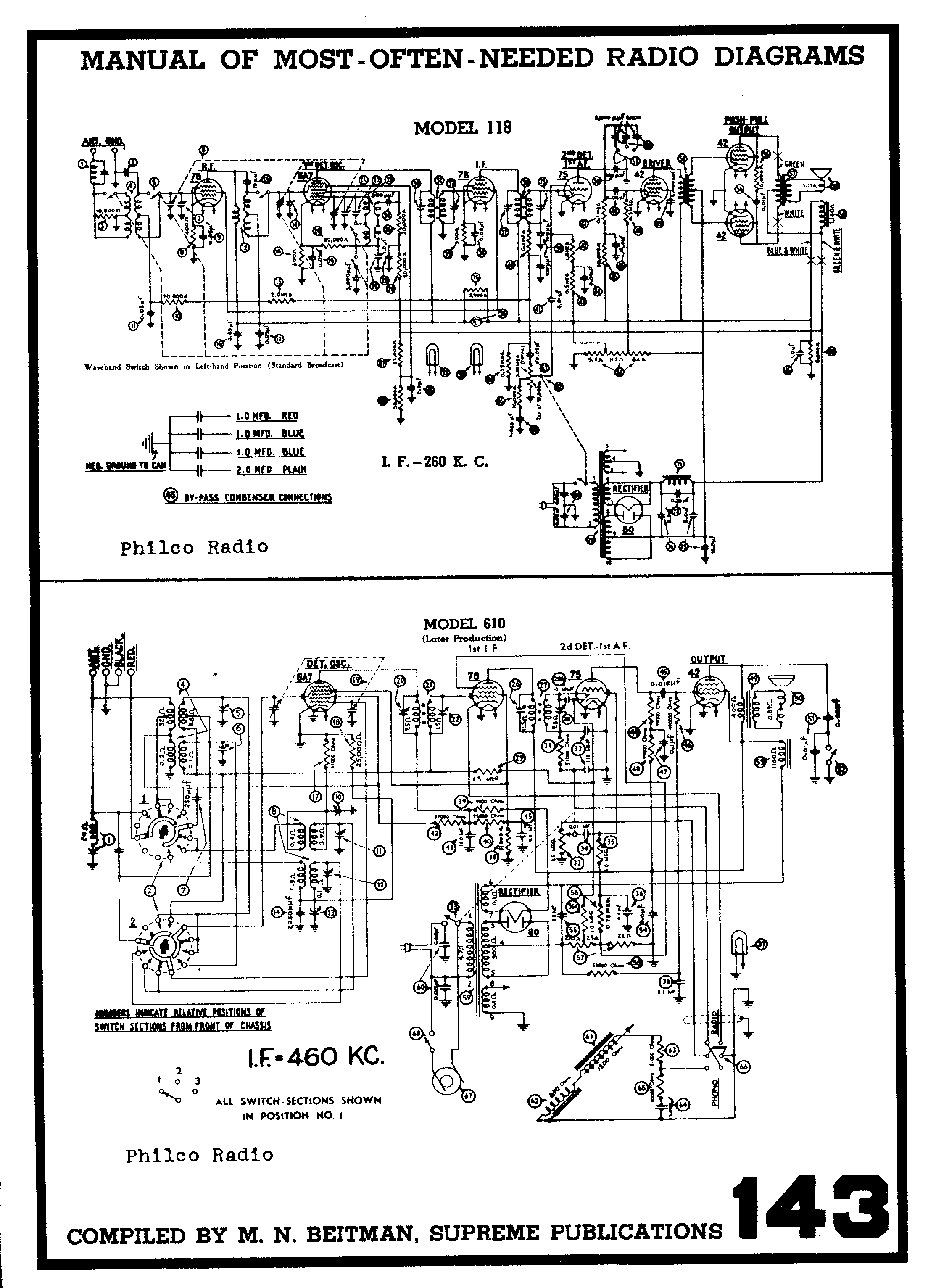

Some info from Beitman

There were a few different flavors of the 610 over the years which can make it more difficult to find the correct schematic. Would help if you could post a picture of the cabinet or any labeling on the chassis or cabinet to help identify the correct version.
