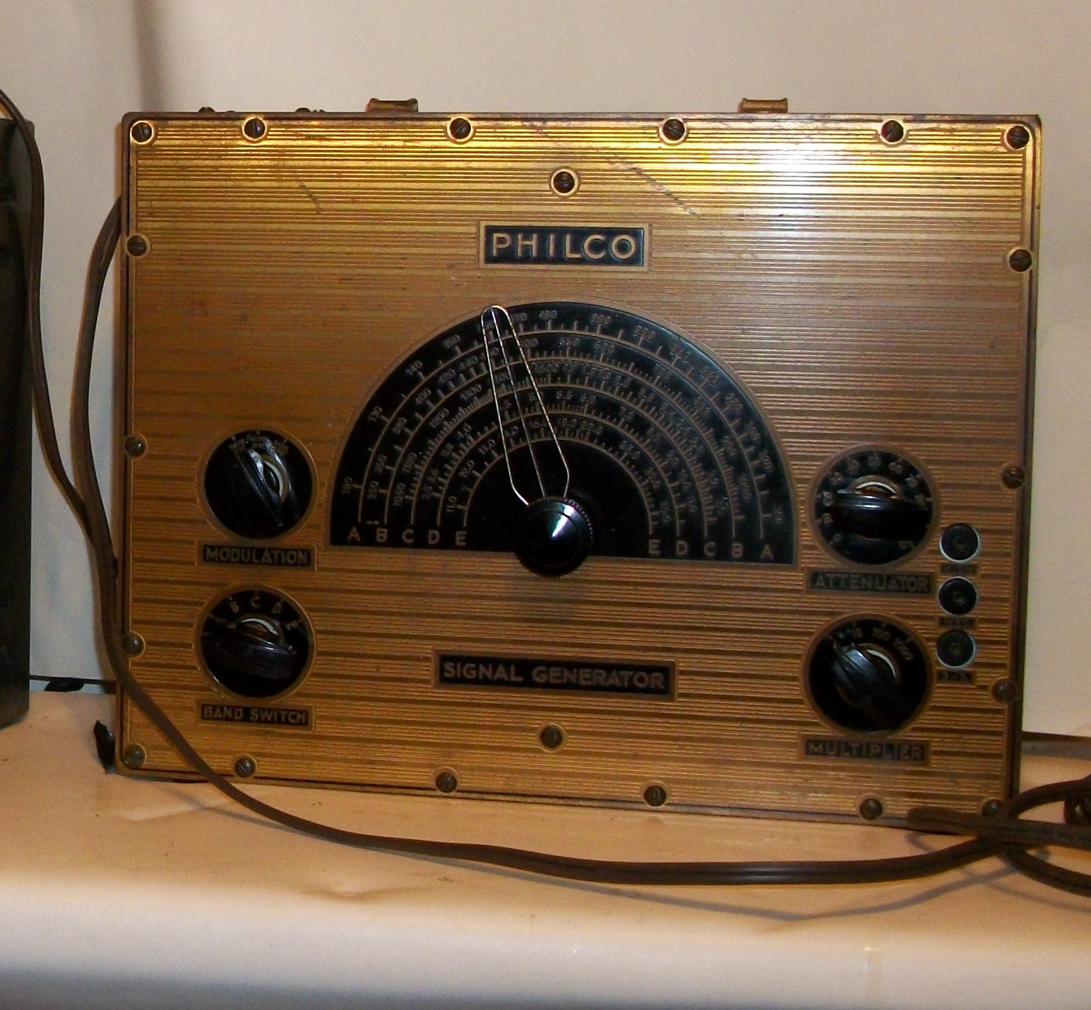

Im looking for someone who has a Philco 077 signal generator
that can help me with getting leads for the one I have. I do not
know what kind of plug that plugs into it. I would like to make a
set, any advice that can help would be appreciated.
What size drill bit will fit into the connector?
A 5/32 slides in an out but stills seams a little loose.
Ok so what you are looking for are banana pin connectors. At 5/32 = a hair over 4mm. Something like this should work.   https://www.ebay.com/itm/10x-BANANNA-4mm...9001!US!-1 If it seem too loose you can pry a little to increase the diameter. Just check the depth of your socket. Along w/these you'll need a piece a coax and a couple of alligator clips.
