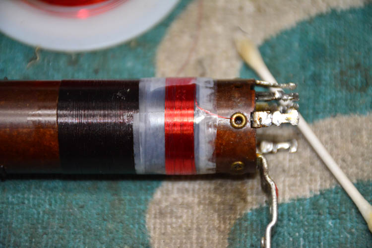

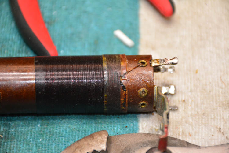

Here is a before and after pic. The coil does not look bad as i don't see any green. But I probably figured it would go bad eventually.
After the original winding was removed, the coil was baked and then sealed with lacquer.
