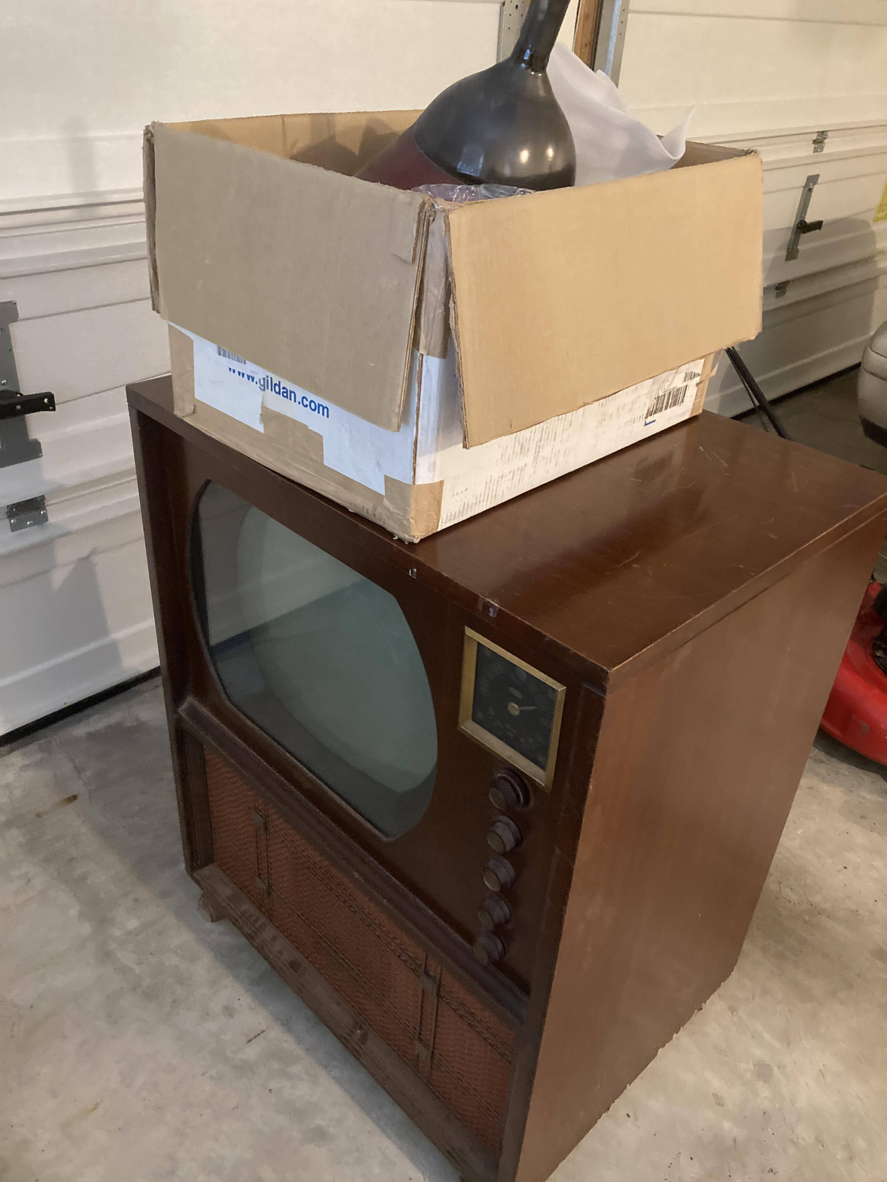

I've just finished my 37-116 (less grill cloth replacement) and am moving on to something a bit different, a DuMont RA-112 (first TV).
We had one when I was a little kid. It was in the basement and never worked. I think my mom gave it to the furnace repairman to get it out of the house, early 1960's.
I'd been looking for one for a while. Then this one literally came to me. A friend of a friend found it and the owner, who never got around to restoring it, offered to deliver it to me. It was nearly free... So now it's made it to the head of the queue, with lots to work on behind it.

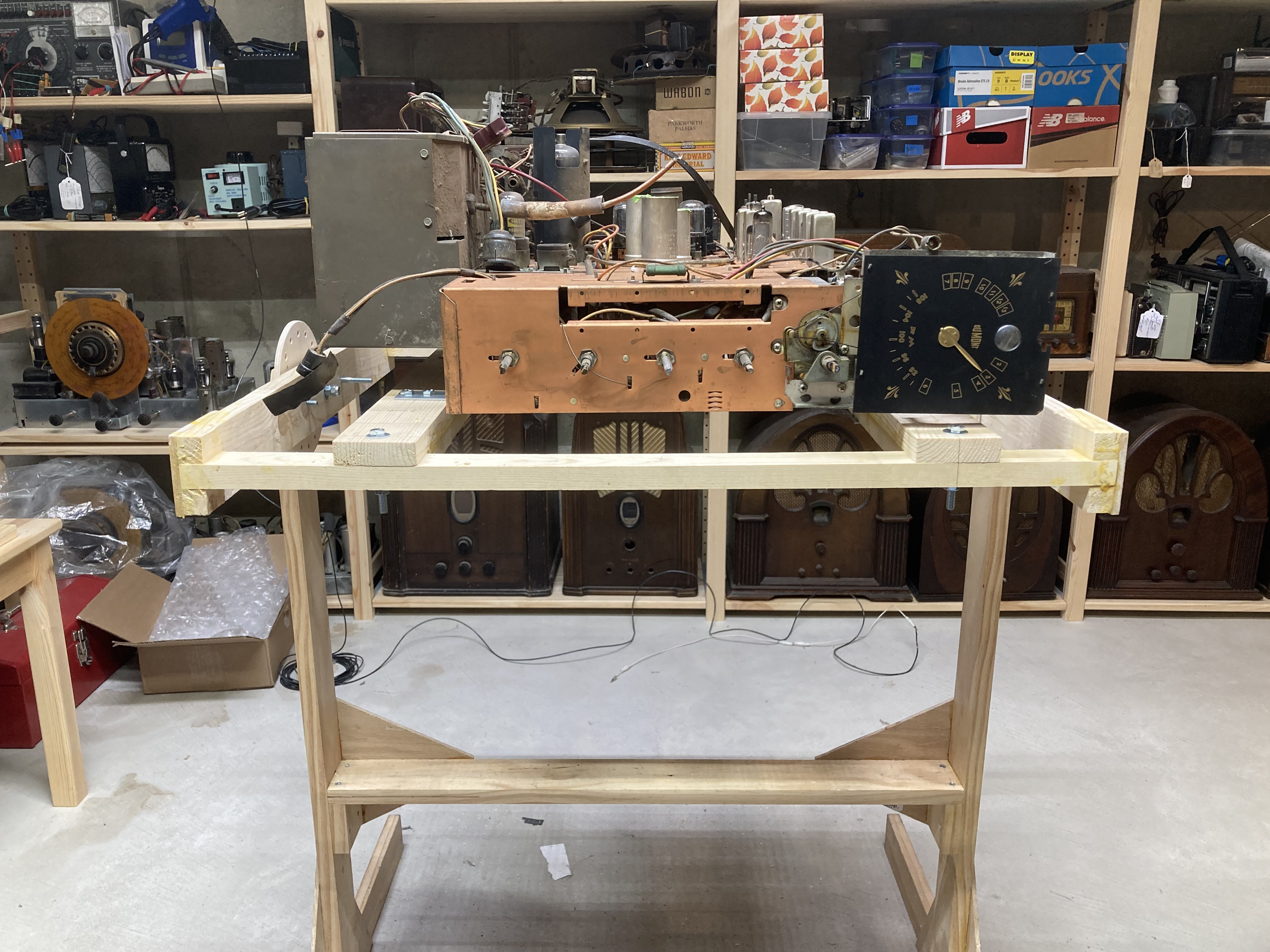

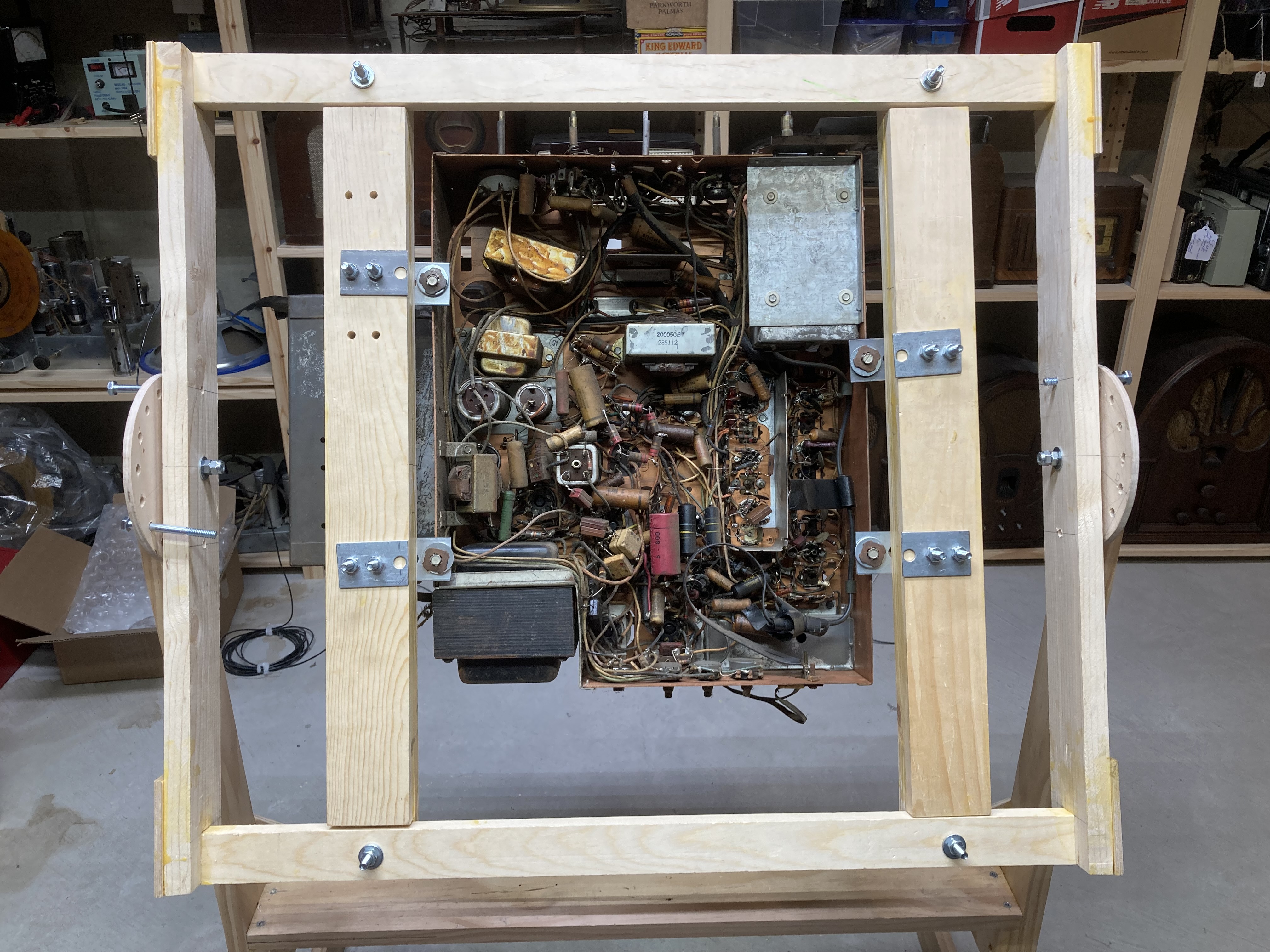

The chassis' relatively huge, so I made a enlarged version of the stand I use for radios. It seems sturdy enough and gives me good access to the underside of the chassis. I have to check to see if the dial can wack the cross piece if I were to let it rotate it that far. That would be bad.
If anybody's had experience with one of these, is there anything special to "look out for"? The tuner is a bit "seized up" and looks mechanically complicated . I figure this project will take a while .

Very nice shop you have there- is that in your garage? Also can see you are a woodworker, shelves and the stand etc.

My shop is the corner of the basement under the family room. I have to confess, the shelves are from IKEA. But the chassis stand is my doing. I need a proper workbench. I currently use a 37 year old wooden table from when I first got out of school. It works.

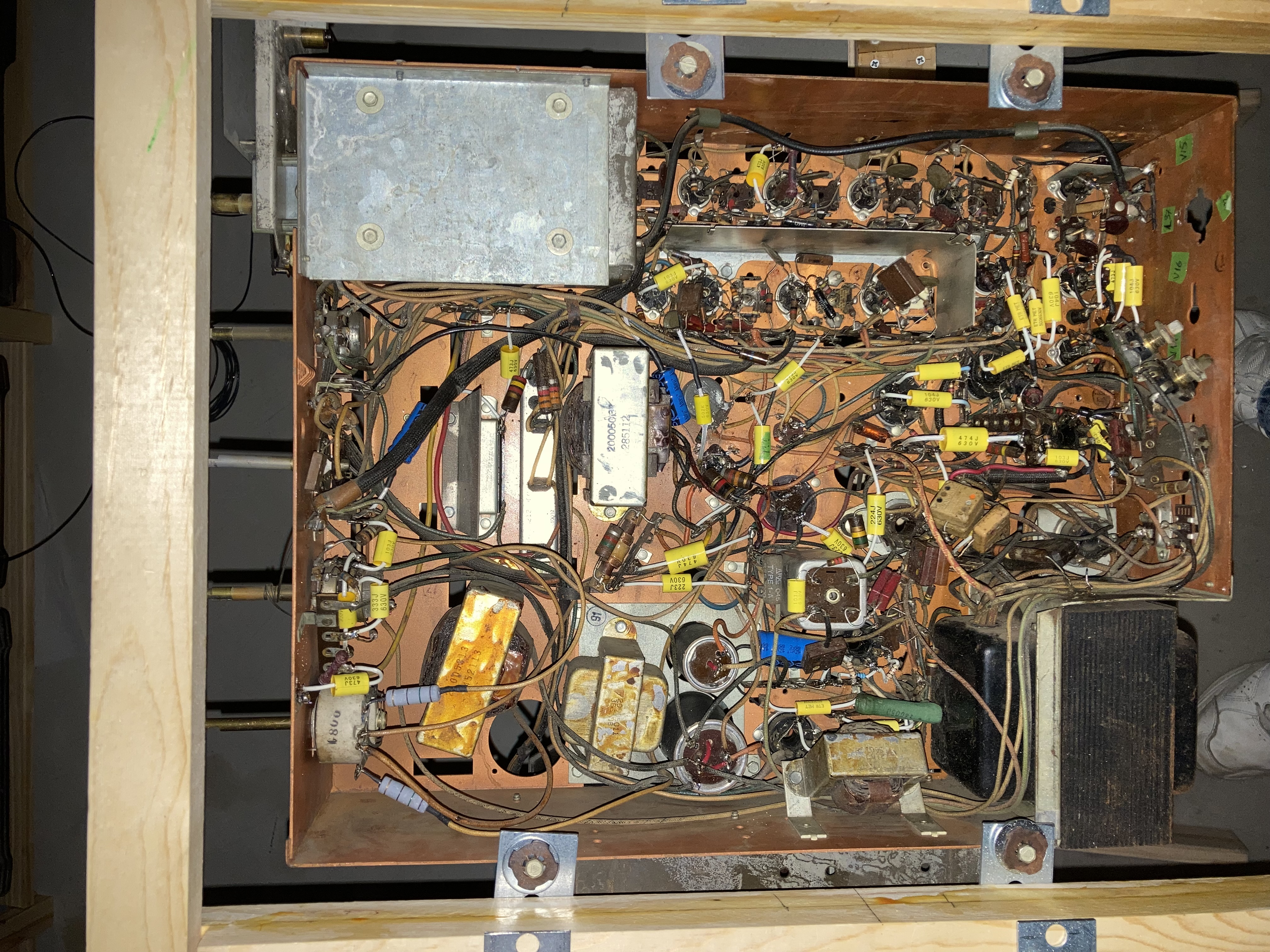

Progress, but not recently. I've got most of the re-capping done, including re-stuffing the electrolytic cans, replacing a few, off value resistors and replacing the very bad, focus-control rheostat. It's been done for several weeks. I need to replace the line filter caps and move on to the high-voltage... At some point I need to take apart and clean the tuner. It's currently seized up pretty well.
I suspect some of the mica caps aren't original. There are a couple of places where there are two in parallel, like someone didn't have the exact value to replace with a single cap.

I powered up the TV for the first time without the HV. I forget exactly at which point (<90V), but as I turned up the variac I heard a snap. I immediately turned it off without looking for smoke, sparks, etc. I tried it again and the same thing happened.
I need to see what's up. I rotated the chassis so I could see the underside. I turned it on again and swear I saw an orange glow coming from the underside of the audio discriminator transformer and turned it off. Very bad. Almost, but not quite, unobtanium if bad.
What's going on. Is it a stray wire clipping? Is it silver-mica whisker?
I removed the transformer to take a closer look. The primary and secondary had continuity and weren't shorted. I meant to measure the 2 caps in it but forgot. There was no way I could see a wire clipping or anything else getting inside of the can to short.
I didn't want to commit to taking it apart to see the 2 caps inside, so I reinstalled it. Maybe I was hallucinating or any "whiskers" that had formed had burned off (pure speculation).
I powered up again. Nothing exciting happened this time. The voltage was set to 117V and all was well, except no sound.
I checked the speaker. The primary was OK, the secondary and/or voice coil were OK. I decided to disconnected one of the secondary transformer wires from the speaker so I could independently check the secondary and the VC. Well the VC had no continuity.
I grabbed a spare Transoceanic speaker and hooked it up and tried again. Finally I heard some noise. I then connected an "antenna" and received a few FM stations. The sound's not great, but it's alive.
The speaker connector plug and socket don't engage well. But that doesn't matter for now.
I'm trying to decide if I want to try to improve the FM reception before or after I try to get the video working.
The way I wrote this is a lot more orderly than the actual process was. Hey, it's my first TV and it has lots of parts

Your arcing could be the silver mica disease in one of the IF cans. Some have the mica caps in the base of the can and can fail, causing arcing, static etc. They can be cut our/disconnected and regular micas soldered in. I oft do TV's in steps against the advice of some. Makes it easier to find any errors. I usually start with the power supply, then horizontal, vertical and sound in that order. Keep the brightness and contrast turned way down just in case you power up with no vertical sweep, and in some cases, no sweep at all. It may save you burning a line or spot on your tube.

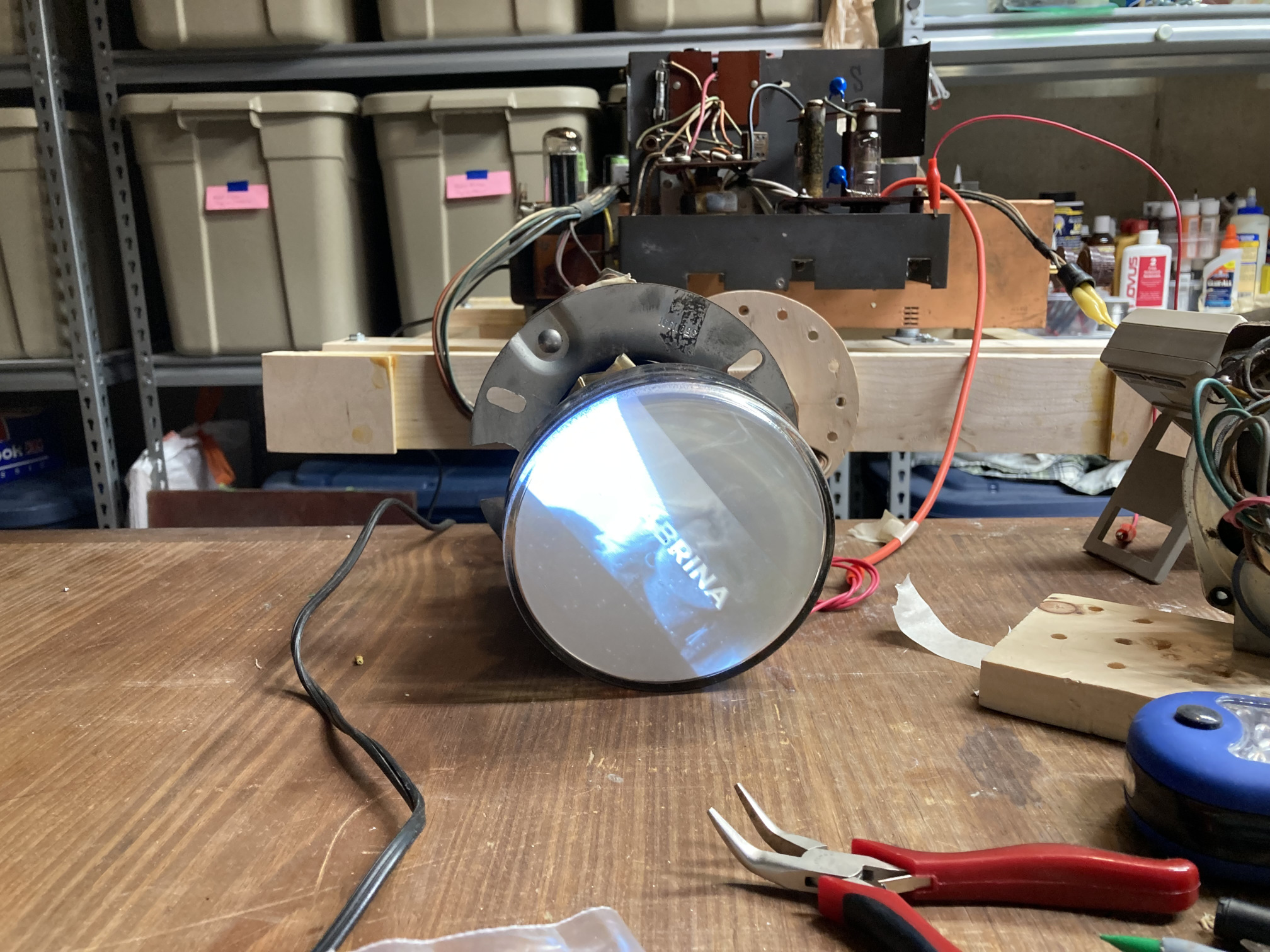

First power up as a TV (not just FM audio) and it works!
Tonight I powered it up with the HV enabled and with a test picture tube. After some tweaking there was a decent picture with not so decent sound. That needs looking into, even FM radio isn't great. But it was the first time I tested the whole thing. My TV knowledgeable friend was over for the spectacle for advice an moral. Fortunately nothing went terribly wrong. Failure is always an option, just not a good one.
It turns out the "snapping" was due to arcing when B+ was hit its peak on power up before dropping to its "normal" value. It went away after some lead dressing in the area. I still need to understand it a bit better and possibly place sleeving on some of the wires in the area.
I found the location of the arcing by turning off the lights and taking a video with my phone during powering up. It was pretty obvious without 300W of lighting beating down on it.
I still need a replacement speaker. I'll look for one at Kutztown in the morning...
It still needs some work, but it seems to be 90% there.
The biggest problem was finding a signal source. My VCR's were both messed up. I think they have belt problems. The DVD players don't have RF outputs. I ended up running a cable across the basement from our CTV splitter and using the one analog decoder box we have.
