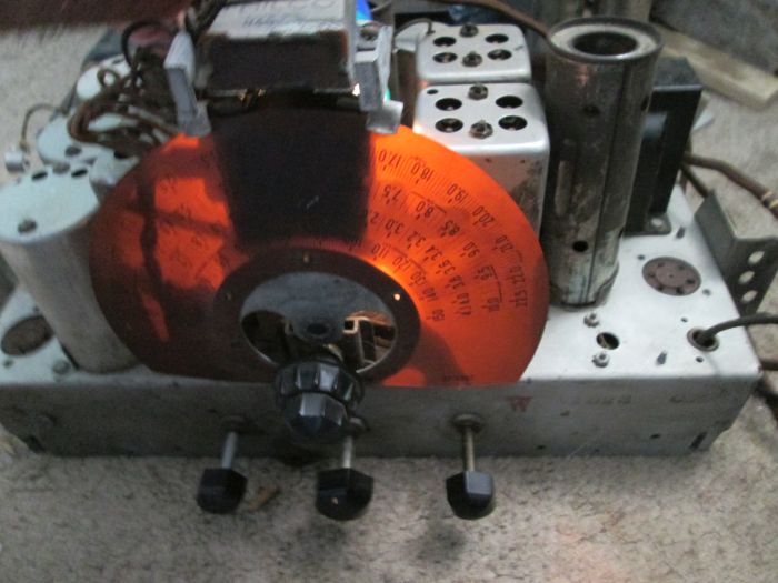

Question is does the control panel have a PHILCO decal on it? One examples in the gallery doesn't really have a good depiction of reality. And the other is original but it doesn't look like it had one. Can't imagine it not having a logo on the set somewhere.

Yes - between the tuning knobs and the escutcheon.
Remember, the dial is upside down, so the decal must also be placed "upside down" so that it is right side up when the dial and escutcheon are closest to you if the unit were sitting next to your easy chair.

I think Mr Huff's set must have the B or X dial in it. That's why his set is oriented backwards. It's confusing to look at if have one. Must have gotten the 1939-40 decal value pack [Image: https://philcoradio.com/phorum/images/sm...on_eek.gif] Not trying to make sport of Mr Huff but just some observations vs an original set would have.
Now that I think of it the dial is going to hard to read with that set up. It will at the far side and the dial is angled away from the viewer. Although the original seems awkward (dial closest to the operator) it makes sense now that way.
Very interesting! So, the 16RX chairside has a different dial than the rest of the 16 line?
In the words of the late Nipsey Russell "Oh Yeah".
The 660L has the same style too where it's closer to the viewer.
