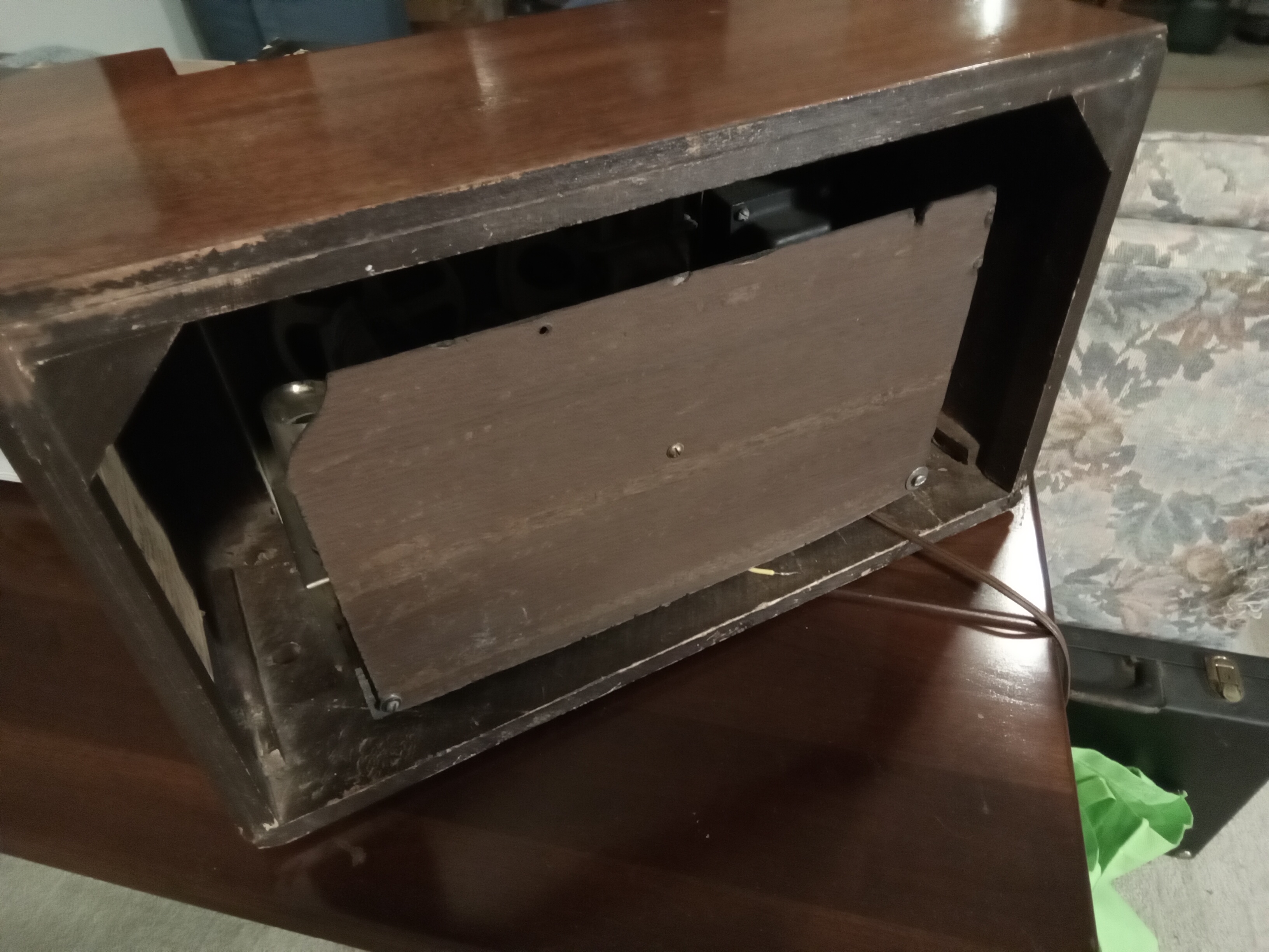

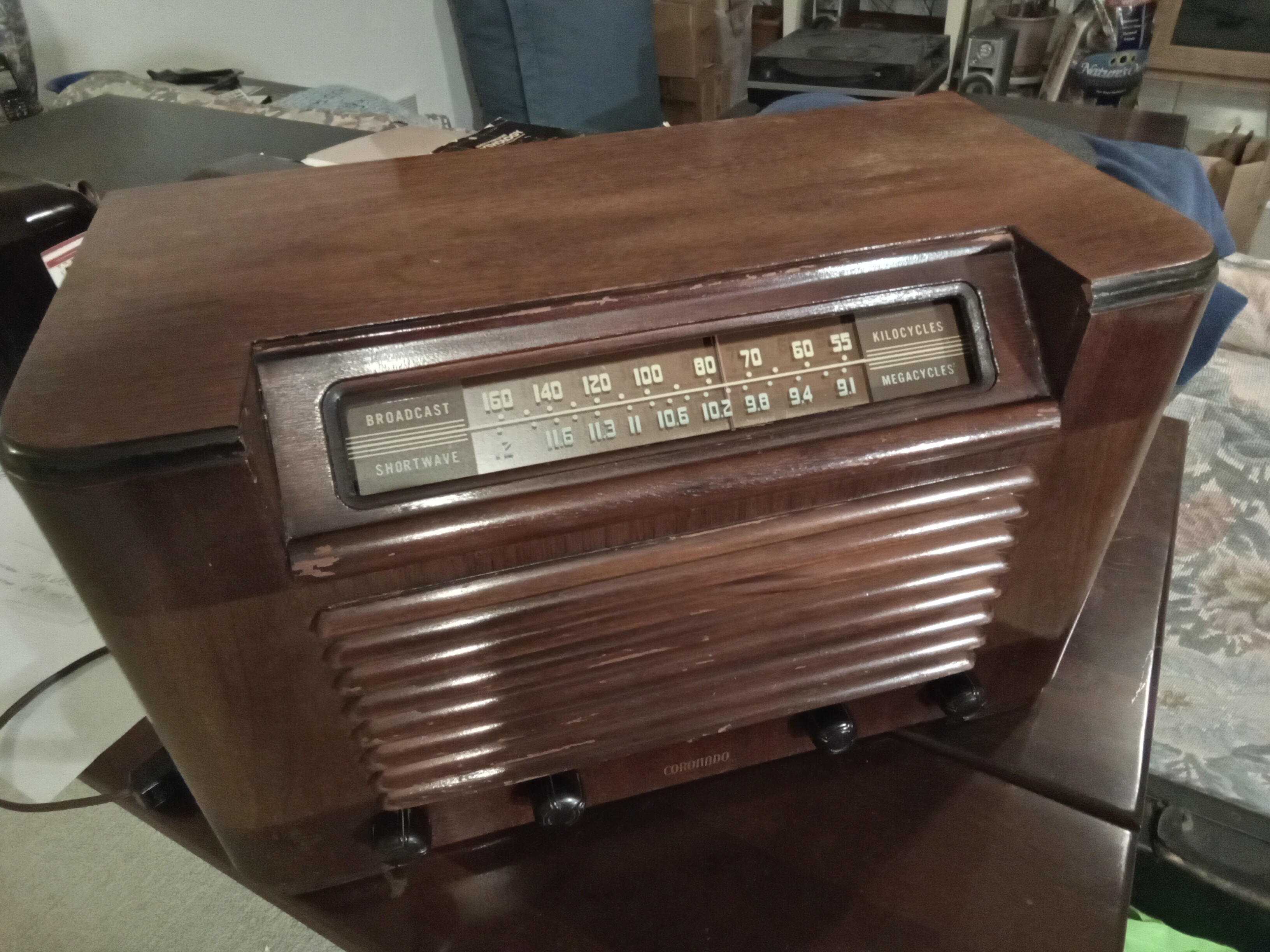

This past week I did a quick recap and repair of this 7 tube Coronado 1682. Also fixed the loose veneer on the top right rear corner and constructed a back with loop antenna from a scrap piece left over from a TV set. Has 2 bands and 3 tone settings. Nice SW spread from 9 to 12 MHz. Another one saved from the scrap pile. Owner and wife are very happy.

What nice little set it reminds me of some those Philco and RCA sets in the little wooden cabinets !

Other than the square antenna the case loks very RCA like a 28X.......and the RCA 28X was AC/DC. Yours looks like a transformer in there.
