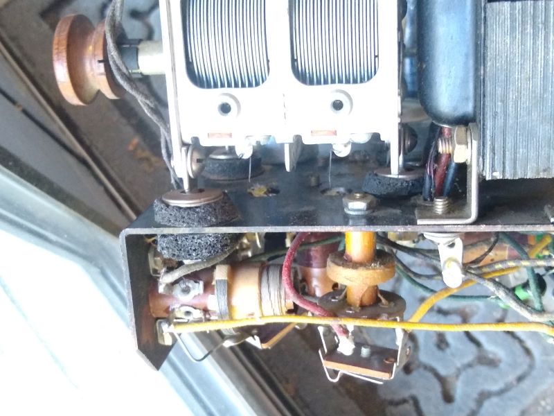

Fine wires leading to the tuning capacitor stators. Notice the osc section on the left has a broken connection. These had so little spare that the breakage was probably due to the additional movement due to the perished rubber mounting grommets:

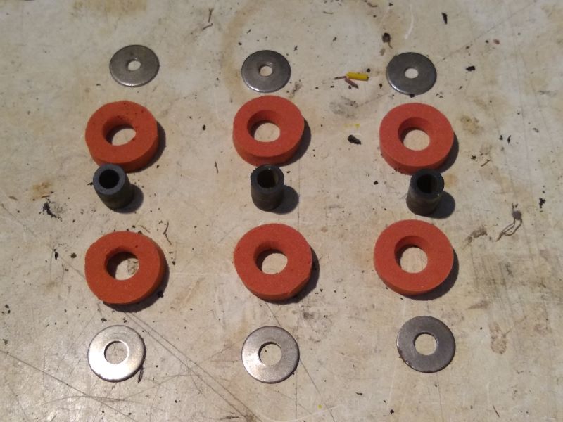

New grommets cur from silicone foam rubber:

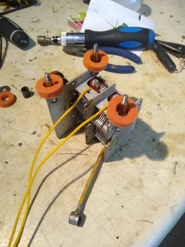

Tuning cap with new wiring, ready for reinstallation.

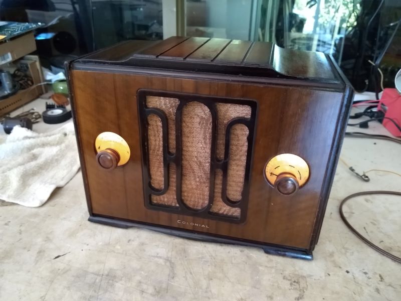

Another one over the finish line. I'm pleased with it and particularly enjoyed working on this radio for some reason I cannot quire explain.
