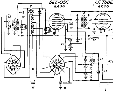

I'm working on this model of Zenith (Riders 1938 WXYZ page 105 ).I have got an i.f. signal through to the speaker with the sig gen connected to the grid of the 6A8 which suggests that all is as it should be in the following sections of the set.
But the "pre 6A8 " tuned sections are proving a problem.I have identified the connections to the first aerial coil located, unshielded, across the bottom of the chassis and from there to the "gimmick " coiled round the grid lead to the 6A8.
The connections to the next coil ,shielded in a can , next to the oscillator coil similarly shielded in a can which is closest to the dial are a mystery to me.Looking into the chassis with the dial away from me there are seven tags on this coil which I have numbered 1 - 7 starting at 11 o'clock for 1 progressing clockwise through to seven. Seven has a red fabric covered wire to it from the wavechange switch. Tag 1 has a green fabric covered wire and the heavy bare wire to the middle gang of the tuning condenser connected to it.

The schematic shows the secondary of the tuning coil #2 to be progressively wound and tapped for the bands. As the bands increase in frequency there is fewer windings less resistance. Therefore using a ohmmeter can detect what wires go where. The same is relatively true for the two other coils the antenna input and the oscillator coil.
If there is no "feeling" of a detent the likely the detent ball is missing or a friction blade has broken, repair as needed or go to Classifieds and post a WTB for a band switch for this model.
Any of the coils could have poor connections or open windings, so if reading the full length of the coil is open locate the open coil and either rewind or request in the classified for a Wanted to Buy.
Though this chassis is used in other models because it is a "Waltons" chassis expect a premium for the part(s).

Another mystery has revealed itself in the meantime. One of the leads to Cap 21 which links the tops of the primary and secondary windings of coil#1 and which sits in the top of coil#1, has corroded away so that part of the circuit was open circuit.
Looking to replace this cap I found when I checked the schematic (a slightly blurry Radiomuseum one ) I found it listed ( in a separate box on the schematic above the R16 listing) as 10 mfd ceramic. Certainly it is ceramic but the capacity at 10 mfd seems very high, especially for such a physically small capacitor. Could the 10mfd be a misprint? If 10mfd is correct why is it ceramic? What should I replace it with? Thanks for your help with this set. And thanks to the Phorum for facilitating this kind of assistance. I'd be lost without it.

"10 mfd ceramic", 10 mmfd or more commonly 10pf. This should be a cylindrical cap that looks more like a resistor. If the lead is corroded off it will have to be replaced. A silver mica will work too or a disc ceramic.
If the cap is holding up progress, a temporary solution is the twist two lengths of #22 solid plastic hook wire together about 1-1/4 inches should be enough for 10pf. Obviously a bit inductive too, but it work until the correct component arrives...

Someone has done some repairs on the #1coil ( and indeed on a lot of the rest of the set including fitting a new power transformer ) and left me in doubt about which is the primary and which the secondary.The repairs were brought about , i think, because the fine wires running down the inside of the coil had broken , perhaps because of greenspot or maybe lightning static build up. Either way plastic coated hookup wire was used to re-link coils to tags and lots of sticky insulating tape were wound round the coil.Taking off the insulating tape I may have inadvertently broken the fine coil wire attached to the black hookup wire - or it may have been open circuit anyway.
But now I am ready to resolder and put it all back together.
However one point of doubt has arisen.One coil, which I thought to be the primary has an ohmmeter reading of 26 ohms. The other has a reading of 2 ohms.Can phorum members clear this up for me ? Which would you say was the primary and which the secondary? Also, is 26 ohms on the high side for a coil in this position or does it seem about right?

I am still wrestling with the front end of this set. On the schematic (which Chas helpfully put up )the aerial connector has three terminals. One is labelled "A" , presumably for antenna . One is labelled "E" for earth. The one in the middle is labelled "Z".Can anyone tell me what "Z" stands for?
Also, on the printed paper schematic there is a dotted line shown between "Z" and earth terminals. This dotting is not clear on the schematic Chas has uploaded but it ( the dotted line between "Z" and earth on the paper schematic)has me confused. Can anyone throw light on this dotting?Does it mean that a busbar should /could be put between "Z" and earth and if so under what conditions?

The dashed line indicates an optional connection since the radio is subject to many environments and has multiple bands with various lengths of antennae. The connection usually has a direct effect on the noise interference recieved.
On the schematic above it looks to me like the terminals are labeled A, Z and G. Maybe somewhere else in the schematic there is a clue to what Z stands for. It's up to the schematic editors as to what to use. Often they are not associated with the manufacturer.
The antenna coils are generally step-up transformers. Considering this, a noise interference signal would also get stepped up. It's a delicate balance.

The A-Z-G terminals are used this way with a single wire antenna:
Connect A to the single wire antenna, connect Z to G and connect G to ground (Earth).
With a doublet antenna transmission line using two twisted wires, connect one wire to A and the other wire to Z, do not connect Z to G. Keep the G connected to earth ground.
The doublet antenna commonly uses a twisted pair of wires and is used as a transmission line to the antenna. The type of connection at the antenna will vary as the transmission line has a characteristic impedance, the antenna connection must match that, yet be broadband for all the shortwave frequencies. The twisted pair transmission line cancels out most noises from inside the home, a good choice if the radio is located well inside the home.

Just a thought -can we assume that the wave change switch as shown in the schematic is in the "broadcast " position ? If this is so with a single wire antenna on "A" and "Z" grounded to "G" the signal will go through the primary of coil#1 and thence to earth.
If my reading of the switch wafers and positions is correct, with the switch in the "broadcast" position the primary of coil#2 is floating ,earthed through R16 (1k ohms )but not connected in any other way to any other part of the circuit.
So "broadcast " signals only reach the grid of the 6A8 through the gimmick ,the primary of coil 2 being not connected to any signal path.
Have I read this correctly?
