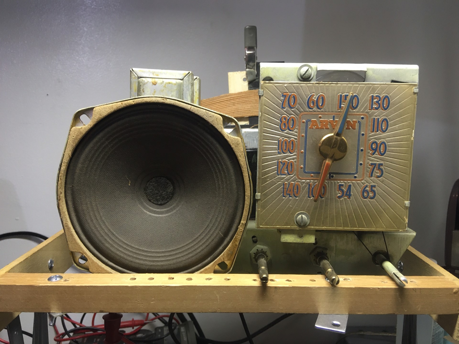

I am finishing up on my Arvin model 664A that was restored years ago by me.
One of the things that I want to do is to find what would be a good substitute for the dial lamp which is night light type bulb .
It is just too bright and produces to much heat . I worry about the Dial cover warping again .
