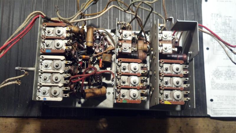

Here is a picture of one of the caps that is "not really difficult" to replace - once you have pulled the sub chassis and all 17 wires. This one has been restuffed (of course) and remounted already. There are 2 in similar positions. Remember, this is also with the sides of the sub chassis removed. You can see the .05(mf).
