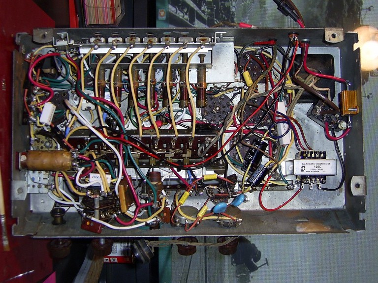

Well, the entire chassis has been rewired, e-caps replaced (I did not change any of the mica caps, as I have no clue how to even test them...) All resistors more than 3% off value were replaced (I even tested the brand new replacements to that spec, Radio Shack quality was, well... Everything is clean, shiny and new looking. All points and contacts have been cleaned.
The only wires I did not replace are coming off the transformer, the AC power switch, the bandswitch light and the speaker (more about this in a minute)
So I took a deep breath and plugged it in, with my wife standing by; nervously holding a fire extinguisher aimed at me.
No sparks, no smoke; so I went ahead and turned on the power. I had already done dim bulb tests at 60, 100 and 120W, which is how I discovered that the output transformer was shot, but this was the first full power up with the bulb taken out of series and that big shiny resistor in its place.
Dials lit up, and the 2 41 tubes, the 6X5 (going to order an 84 to replace it soon!) and the 2 XXL tubes all started heating up and cheerfully glowing -none of the 7 series tubes did (7A6, 7C6 and 2 7B7's).
Then I smelled burned insulation and a trickle of smoke came up by the dial lamp. Icon_sick
I unplugged it, turned the chassis on its side and tried again.
Turned out that the wire from the Bakelite block to the power switch (one of the few wires along with the power transformer wiring that I did Not replace, even though I re capped the bakelite block itself) was burning up right at the switch, so I clipped it off and soldered on a new wire. No more smoke, no more burnt insulation smell. The switch performs flawlessly.
But now I am second guessing myself; should I remove the transformer and replace those last few wires? They are braided and seem to be in pretty decent shape, but so did the one running into the switch block... Should I replace the switch altogether?
Next: What should I expect to have coming from the speaker with only the 2 41's the 2 XXL's and the 6X5 (84) tube operational? Is there any troubleshooting or work I can accomplish without the other tubes?

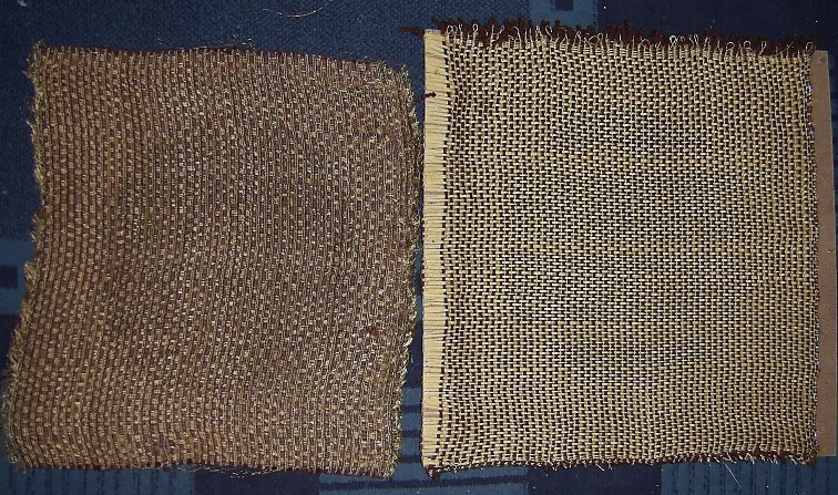

I still have the original grill cloth carefully stored, and as I said somewhere else, it has some cat damage and a stain or two. Hopefully tomorrow I can post pics of it and the replacement I made.
Ron or Arran or anybody interested in the 2'X2' original? Plenty of usable cloth for smaller applications. Just let me know what you think I should do after you see it.

Before buying a bunch of tubes, check to make sure you have filament voltages at each of the sockets (pins 1 & 8, IIRC) where the tubes are not lit. It may just be a problem with a filament line that has opened up.
You won't get much without the rest of those tubes in circuit. The most troubleshooting you would be able to do is to introduce a signal (touch with a screwdriver) the input grids of the 41's and listen for hum. It won't be very loud.
You also may want to carefully clean the pins of the tubes that do not light. The loctal tubes are known to get corrosion on their socket pins, leading to poor contact and bad connections. It is highly unlikely that you would have four tubes with burned out filaments.
If the transformer leads are in good condition, it might be best to leave them alone. Removing the transformer and trying to replace the wires will probably do more harm than good, since you would have to disturb the delicate connections to the high voltage winding.
Nice work, judging from the pictures. I have a 41-280 that has the separate dial light for each band as shown in the Riders schematic I got years ago from another restorer. All of the other 1941 Philcos I have seen use a single bulb in a hinged holder as you describe. I can only assume that the difference was a cost-saving mid-production change.
I can't believe you wove your own grill cloth. I've never heard of any restorer doing that before.
I don't think you can do much of value without your IF and detector tubes. If you have an oscilloscope you might be able to confirm that your oscillator is putting out near the correct frequencies (high impedance probe on Osc XXL plate or maybe on cap #31 if you have the same 41-285 schematic numbering I do.) With a scope you might also confirm antenna coil and push button operation with a probe at the grid of the 1st Detector XXL. But most of your troubleshooting and alignment will need to wait until you have a full tube set.
You can also carry out basic troubleshooting steps to confirm the final amp functioning by touching the plate side of cap #52 (coupler between plate of 1st audio 7C6 and grid of 41s) with an operating soldering iron and listening for the loud hum from your speaker, but if you can hear any hiss or slight hum with the radio on, this test is probably unnecessary.

Thanks for the suggestions and the kind words -to be honest, I mainly followed badrestorer's 41-255 step by step job to see how I should do mine.
If you look closely, I did install the ipod jack in an existing chassis hole, and ran it to the 920-1600KC spot on the pushbutton assembly by unsoldering the antenna coil carefully and gently shrink tubing it. Not sure if this will work, but it is an easy fix if it doesn't.
Oh, here's a fast shot of my grill cloth; the loom was barely big enough, so I have to stretch it into a bit better shape; it will be square and straight when I am done. Next to it is the original cloth (note the bloodstain and cat damage on the right hand side, maybe a couple inches into the material). I chose the colors for the new one using the threads at the edges that never saw sunlight or smoke etc.
Will try your suggestions later today.
My wife thinks it looks closer to correct than I do, but I also tend to be a bit too detail oriented... but it will do until I can afford better. 5,400+ feet of stinking thread...
