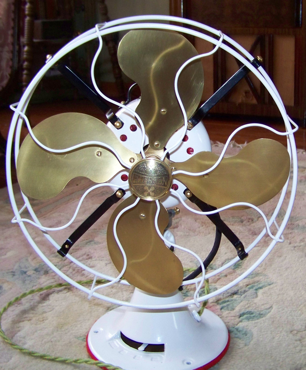

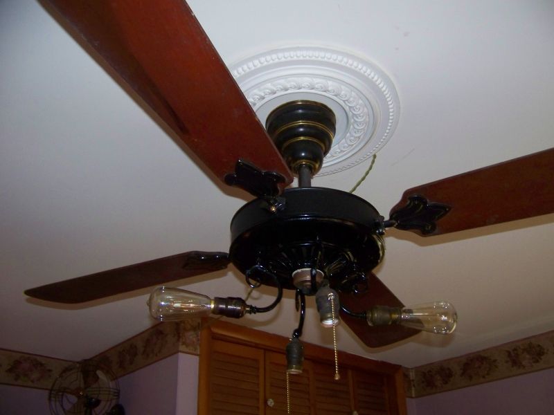

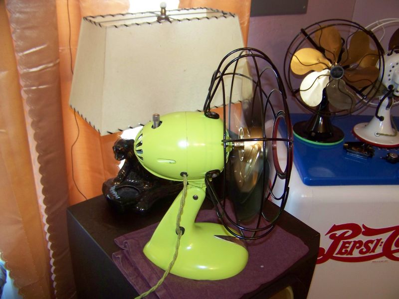

I have a few radios..... vintage electric fans and lighting are my main hobby .
Nice Fans!
