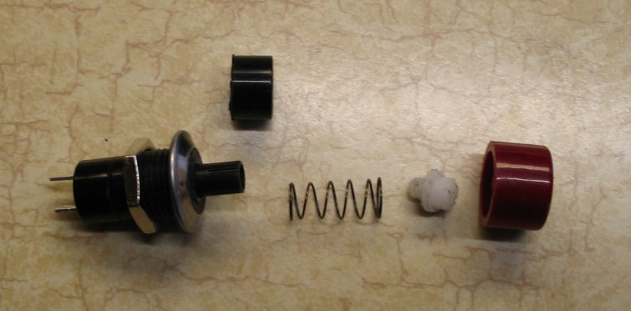

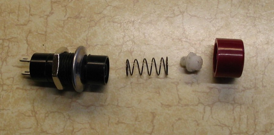

            The fix was easier than I first thought. Given the construction of the push button switch assembly, it would have required some major disassembly to install a switch that was held in place by a nut. Also, I didn’t just want to epoxy a new switch in place as that can be a mess to deal with if the switch would ever need to be replaced in the future.
I used the Radio Shack 275-0011 switch recommended by Ron. I started by pulling the red pushbutton off and unscrewing the small white spring retainer and spring from the plunger. The black switch body had sort of a collar around the plunger, I guess to provide some protection for the plunger. Anyway, I cut this off with a razor saw as shown in the second picture. This made it possible for the plunger to fit into the hole in the back of the push button assembly. The length of the plunger was just the right length for the metal actuator to operate the switch properly.
