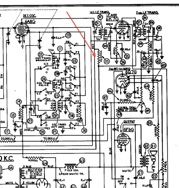

Hi All,
This is sort of a techy question but, as I work through the IF section on my 37-620 checking values, I see that resistor Part 33 is 10K on the schematic, but 1K on the parts list. Turns out it looks original and is in fact 1K (1.1K actually).
Looking at the socket voltages (haven’t ever been able to fire it up due to its poor condition) the plate of the first IF is 250V and the plate of the Det.Osc. is 245V. So 5V is dropped across Part 33. That’s only .5 ma. My theory is probably a little weak but that doesn’t seem like enough current to run both the 6A8 and the RF section 6K7. In fact it doesn’t seem like enough to run either tube alone. OK, so 1K is probably correct, the radio must have worked at some point. So anyway, why bother to put in a 1K at all? Seems like it would work fine without that resistor.
Anybody got any thoughts on this?

That resistor looks like a decoupling resistor, used to isolate the power supply of the IF stage from the converter and RF stages. Sometimes if B+ power is applied to all stages from the same source, you may get instability or oscillations due to the common power source. The resistor, together with a bypass cap serves to filter the supply and isolate the stages from each other preventing the problem.
Most likely, the 10K value on the schematic was a typo, all to common on the Philco schematics. The plates of the 6K7 and 6A8 probably draw about 10 mA total, so there would be a voltage drop of 10 volts or so across 1K which seems reasonable. A 10K would give 100V of drop which would clearly be excessive.
When they install a resistor in the plate circuit of a tube a lot of it has to do with the potential between elements. Since this is used in the plate circuit of the 6A8 convertor tube I would replace it with one of an identical value, Philco was not in the habit of adding parts without a reason.
