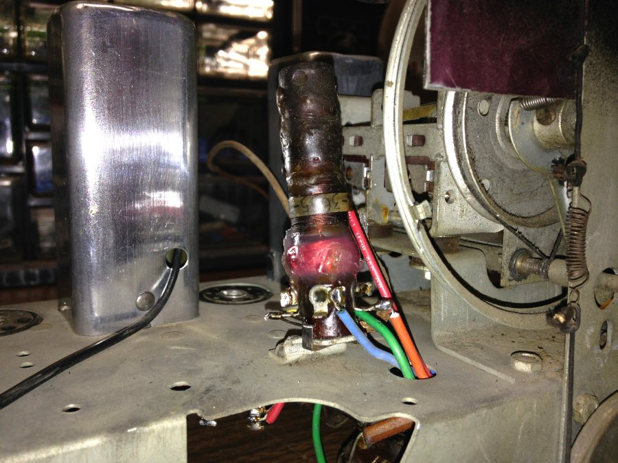

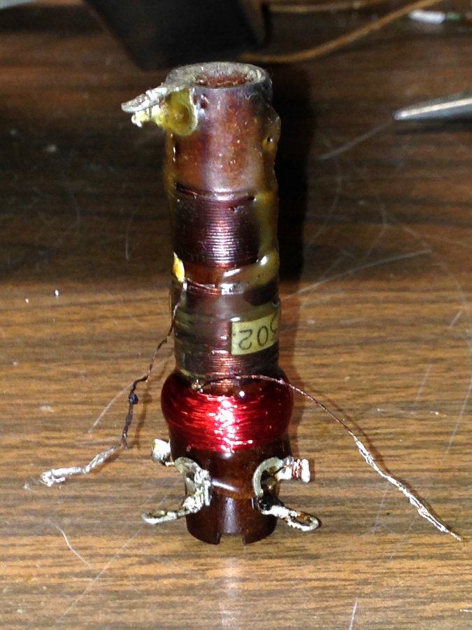

AM primary of the antenna coil is now rewound...
[Image: http://www.philcoradio.com/images/phorum...e00009.jpg]
Not the neatest job, but it should work since this is merely the primary of the AM antenna coil.
It is 350 turns of 38 gauge wire. The original resistance of this winding, according to the schematic, is 33 ohms. This one is measuring 28 ohms, close enough.
I checked the resistance of the other windings and they are all OK.
I'll reinstall it in a bit, and replace some more wires while I am at it.
Same exact way i rewound the burnt antenna coil in the Emerson I restored a year ago.
Worked like a charm.

In the case of the 42-720 coil, I was able to unwind most of the windings of the AM antenna coil primary, so I could make a fairly close estimate of the total number of turns.
I was going to get out my micrometer and measure the size of the old wire, but as usual for me, I was so focused on rewinding the coil that I forgot. The original may have been 39 gauge since the total resistance ended up a bit off, but the coil should still work as the antenna primary isn't as critical as, for example, one of the oscillator coils.

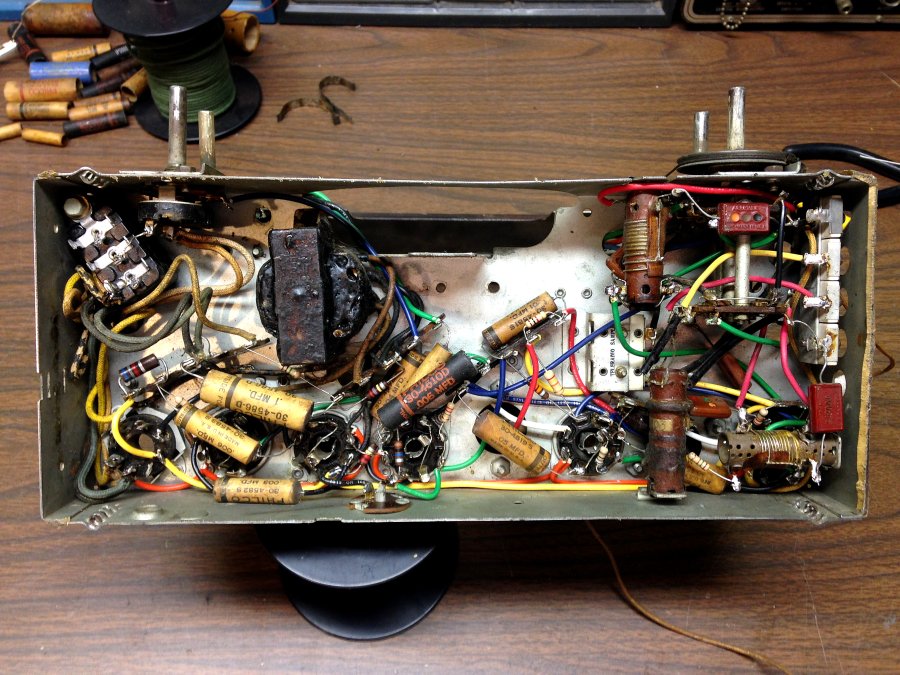

Review: Here is how the underneath of the chassis looked before I began working on this set:
[Image: http://www.philcoradio.com/images/phorum...e00002.jpg]
And here is how it looks now:
[Image: http://www.philcoradio.com/images/phorum...e00010.jpg]
I've replaced every wire that I could reach. A few wires in the vicinity of the band switch received color-coded heat shrink tubing as I was not able to reach both ends of those wires with a soldering iron without risking damage to a coil or other wires in the process. Three rubber-covered wires remain; these three connect to ground and even if the dried out rubber falls off, they are not touching anything else and should be OK.
Here's the antenna coil which I rewound the AM primary winding on, back in place on top of the chassis:
[Image: http://www.philcoradio.com/images/phorum...e00012.jpg]

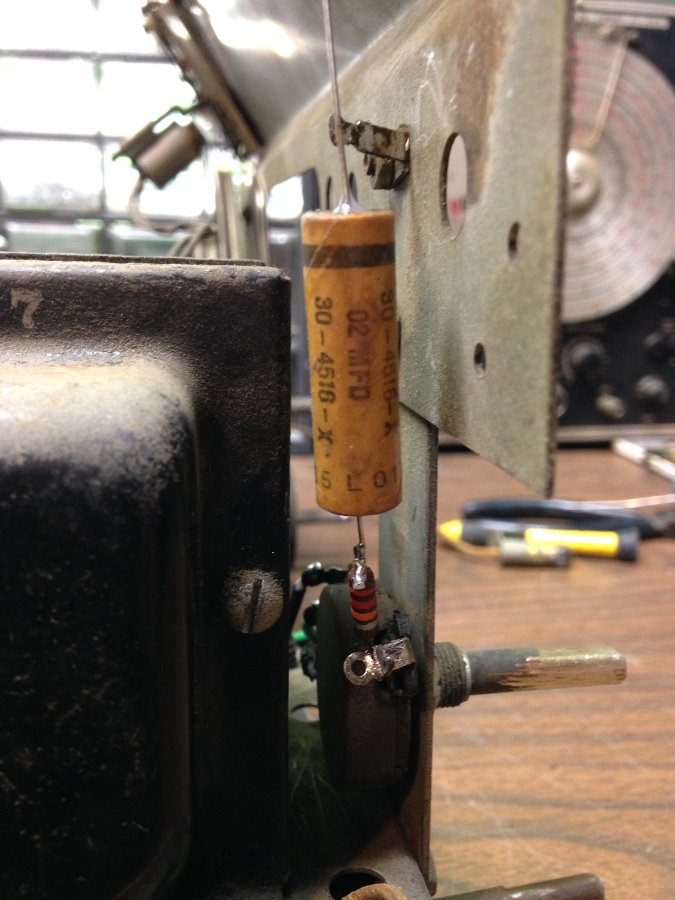

I've even replaced the resistor (29) and capacitor (30) which connect between the volume control loudness tap and ground. Here is a difference between the 42-724 and the 42-720: In the 724, this combination is 10K ohms and 0.1 uF. In the 720, it was 22K and .02 uF. The replacements are 22K and .022 uF inside the original .02 uF sleeve.
[Image: http://www.philcoradio.com/images/phorum...e00014.jpg]
You will note the grounded end of (30) is not yet connected to the solder lug. This is because that lug is on the back of the dial scale backing plate, and that will have to be removed, painted, and re-flocked once the flocking material gets here.

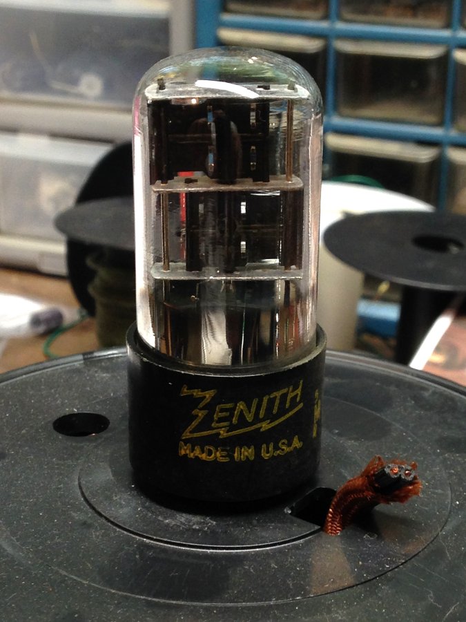

After electrolytic installation, I tested all six tubes. Two were bad.
A 7B7E tested dead...and the dreaded 6X5 had P-K shorts!
[Image: http://www.philcoradio.com/images/phorum...e00019.jpg]
Imagine that, a Brand Z 6X5, at that.
I had good, tested spares for each, and these were installed.

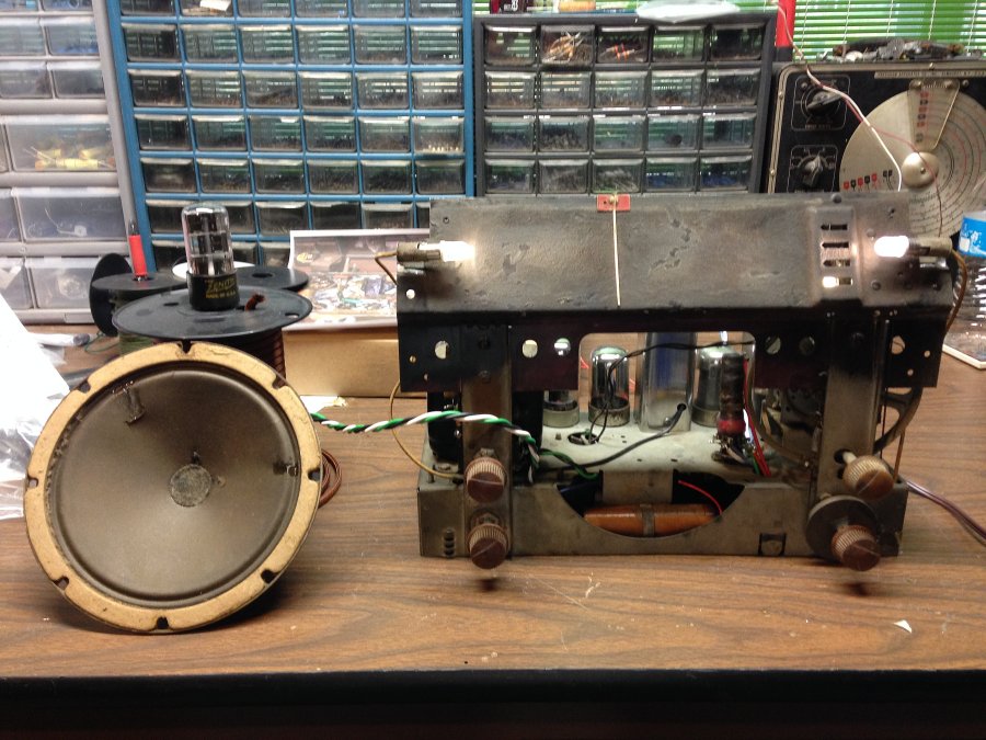

Once these were in place, the set was turned on...and it came to life:
[Image: http://www.philcoradio.com/images/phorum...e00018.jpg]
It was barely picking anything up; the strongest signal was my SSTRAN signal which came through loud and clear.
