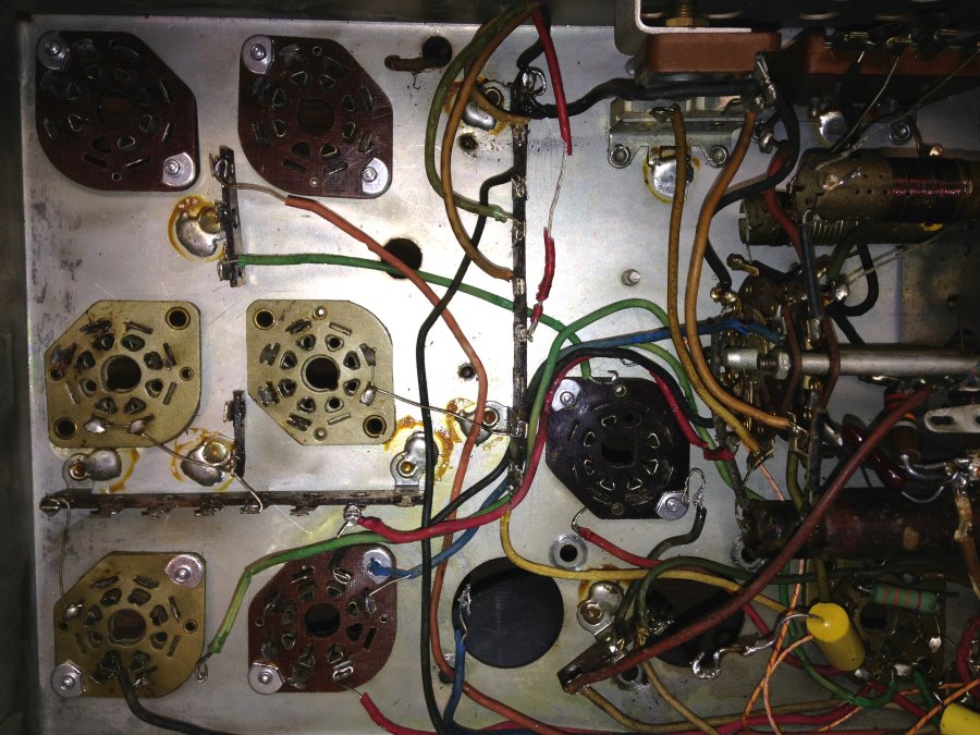

[Image: http://www.philcoradio.com/images/phorum...770-15.jpg]
As you can see, I went in and removed nearly everything from the IF amp through the audio outputs. I think it will be easier this way. It has to be rewired anyway due to the dried-out, nasty rubber-covered wires.
Arran, I was able to remove everything from the other tube sockets in this area which I want to keep without any other contacts breaking or otherwise coming off from heat. I found that it was easier to remove wiring from contacts when I had a tube plugged into the socket I wanted to keep.
So...as it looks right now, I will only have to replace the 6H6G (2nd detector) and the two 6F6G (audio output) sockets. I'm hoping I can save the det-osc, rectifier, and tuning light tube sockets as well. We shall see. But since I've completely stripped this area, I will concentrate on it first.

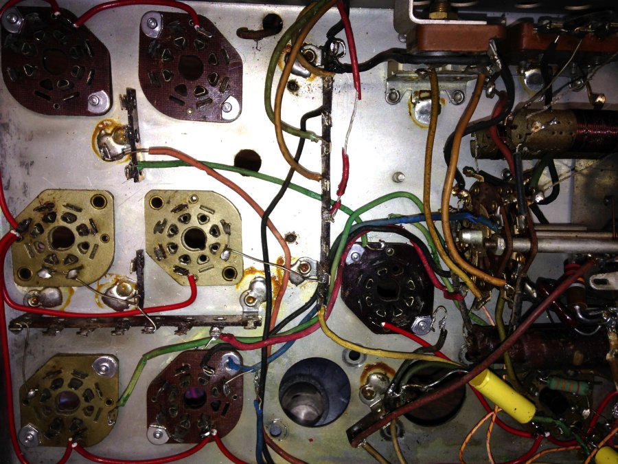

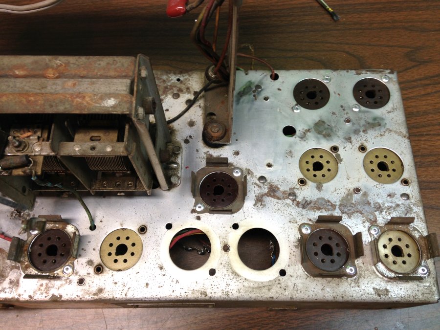

I have replaced five tube sockets.
I have added tube shield bases where this set originally had them.

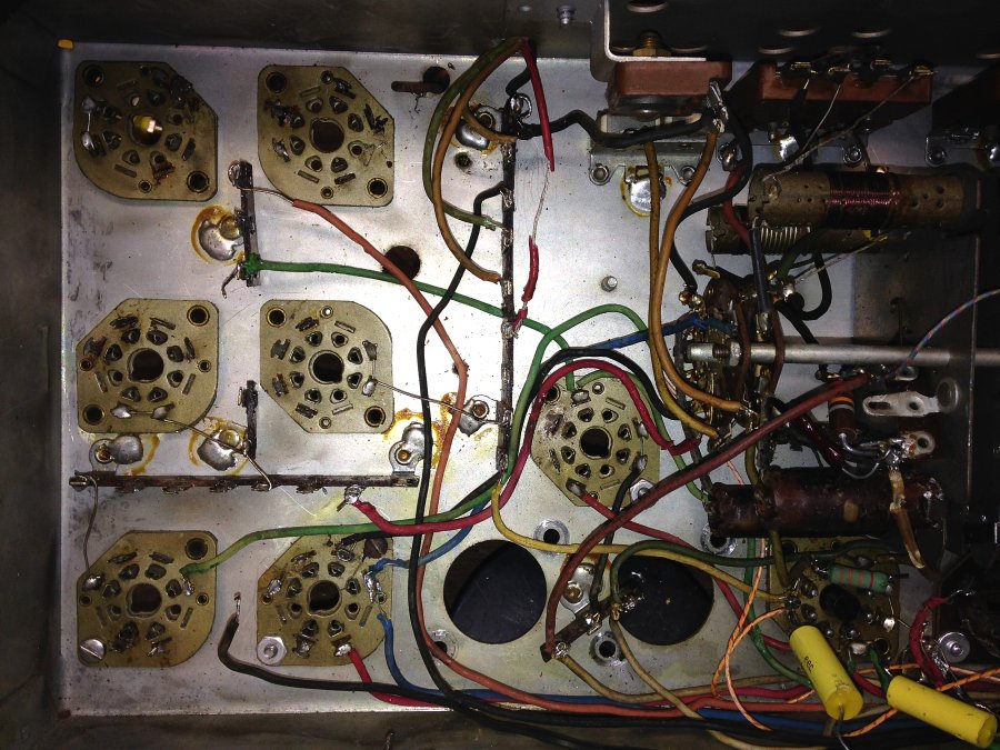

[Image: http://www.philcoradio.com/images/phorum...770-16.jpg]
As I mentioned previously, I like these 1937 tube shield bases much better as they allow you to use any type of tube you wish.
Under-chassis view:
[Image: http://www.philcoradio.com/images/phorum...770-17.jpg]
I replaced the IF tube socket for one reason: I wanted to be able to ground pin 1 (metal shell) in case a metal tube ever gets used there. The original socket had no contact at pin 1.
Now comes the fun of rewiring, then installing new resistors and capacitors.

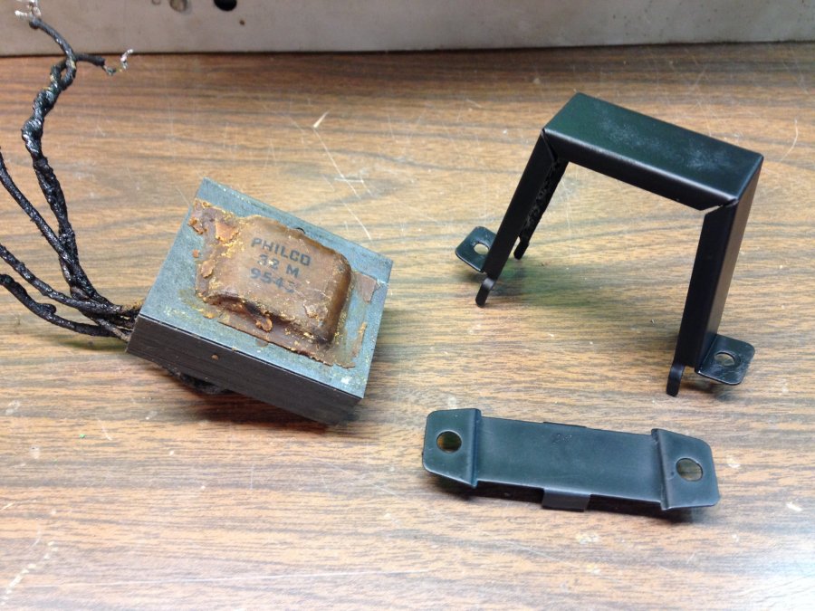

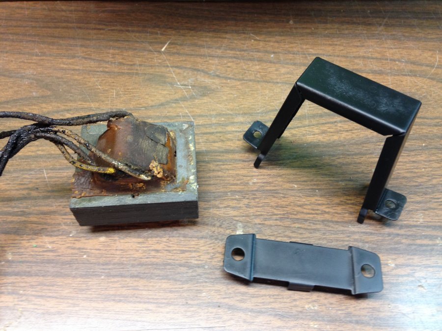

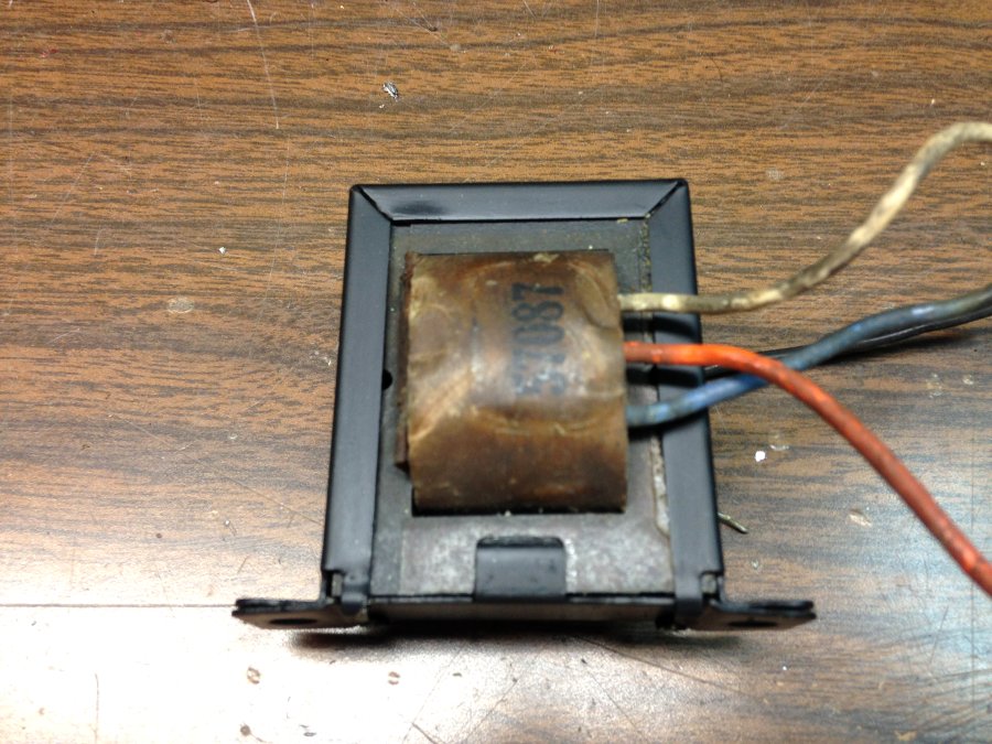

For Sam:
Pictures of the original audio output transformer.
[Image: http://www.philcoradio.com/images/phorum...770-18.jpg]
[Image: http://www.philcoradio.com/images/phorum...770-19.jpg]
Roughly half of the wax has been removed here, and as you can see, the mounting shell has been removed, cleaned, and repainted as the top of the transformer was very rusty.
If you can imagine all of this together, and with twice as much wax over the windings and over part of the mounting shell...that is how it looked when I pulled it from the radio.

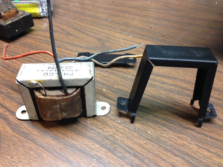

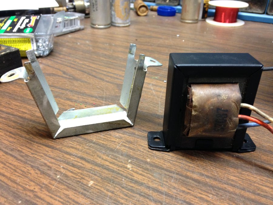

Let's make the 46-1226 transformer fit the 39-770 frame.
[Image: http://www.philcoradio.com/images/phorum...770-20.jpg]
Here is the 46-1226 transformer (left). Its core will be removed from its original mounting frame and installed into the 39-770 mounting frame.

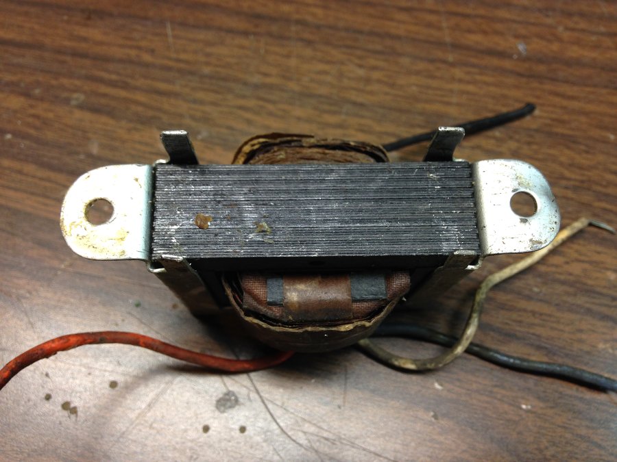

[Image: http://www.philcoradio.com/images/phorum...770-21.jpg]
I unsoldered the grounded lead of the audio output secondary from the frame.
Then, I unfolded the "ears" on the bottom which holds the frame in place, and then pried the frame open enough so that the core could be removed. Next, the core was turned sideways to fit in the 39-770 frame, the bottom piece was put in place, and its mounting "ears" were folded back over.
[Image: http://www.philcoradio.com/images/phorum...770-22.jpg]
Voila! The core of the 46-1226 transformer is now in the 39-770 frame.

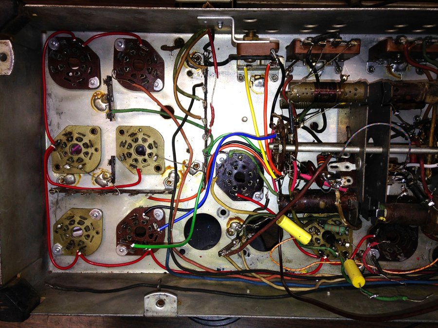

Now, let the rewiring begin:
[Image: http://www.philcoradio.com/images/phorum...770-24.jpg]
I have attached filament leads (the new red wires visible in the photo above) to one side of each tube socket, from the 6K7G RF amp through to each of the 6F6G audio output tubes.
One side of the filament line is grounded in this set, so I will get to those later in the process.
...a little more rewiring...
[Image: http://www.philcoradio.com/images/phorum...770-25.jpg]
I've replaced all of the wires on bandswitch wafer "P". That wasn't easy!
The good news is that I'm nearly ready to start installing new components on the left side.

(02-03-2015, 01:16 PM)Ron Ramirez Wrote: It's time to get radical.
[Image: http://i326.photobucket.com/albums/k420/...g~original]
