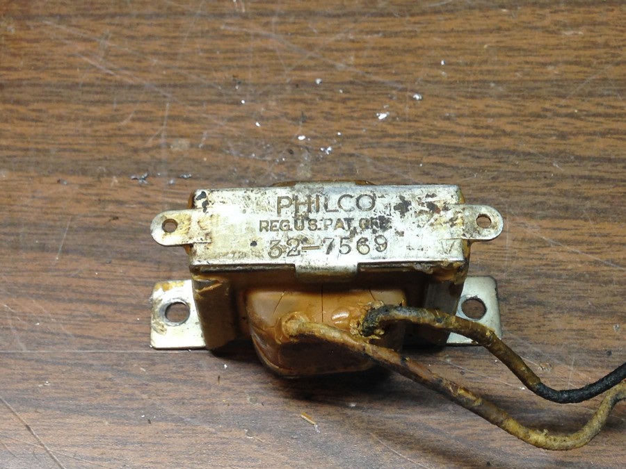

Found it. Choke (59), 2250 ohms, is open. This kills B+ to the det-osc and IF tubes. No wonder it won't work!

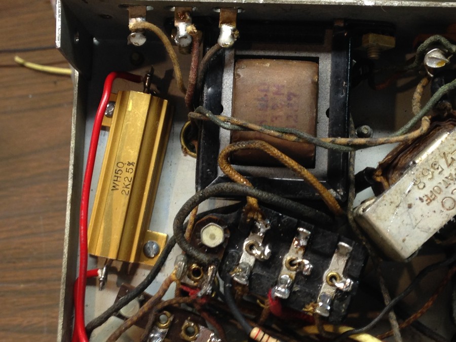

Looking around in my stash o'stuff, I found a 2200 ohm chassis mount resistor. 50 watts, which is overkill, but hey, I have it so I tried it.
Worked like a charm...the radio now picks up my SSTRAN and I can barely hear a few other AM stations with my ear close to the speaker...

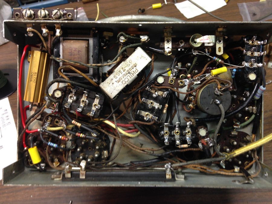

As a refresher, here's how the chassis did look:
[Image: http://www.philcoradio.com/images/phorum..._00021.jpg]
and how it looks now:
[Image: http://www.philcoradio.com/images/phorum..._00023.jpg]
[Image: http://www.philcoradio.com/images/phorum..._00024.jpg]
And here is the open choke:
[Image: http://www.philcoradio.com/images/phorum..._00025.jpg]
