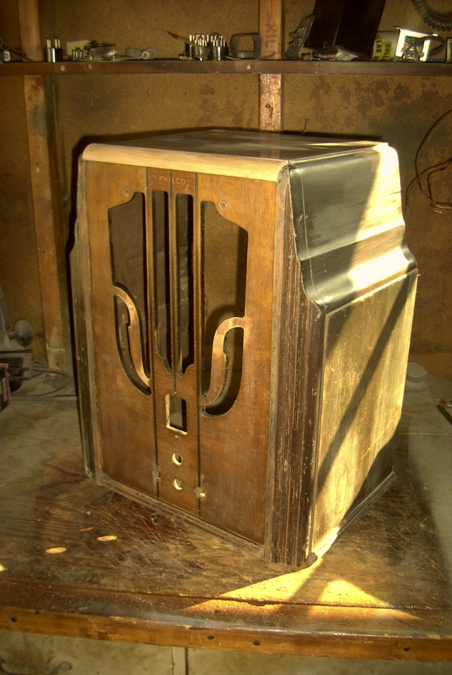

Here is how the 32B cabinet looked once I completed repairs to the cabinet.
[Image: http://www.philcoradio.com/images/phorum...89_011.jpg]

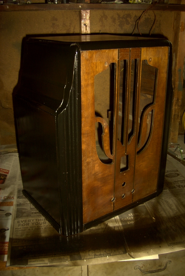

And now, after the Behlens Extra Dark Walnut toner had been applied to the top, sides and trim:
[Image: http://www.philcoradio.com/images/phorum...89_012.jpg]

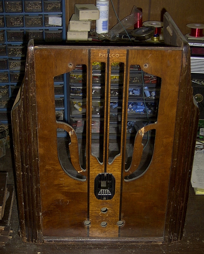

By way of review, here is how the 32B cabinet looked before I finished gluing it together:
[Image: http://www.philcoradio.com/images/phorum...89_005.jpg]
As you can see, the top is off. You can sort of see, if you look closely, that the left shoulder is also missing.
Imagine if you will:
* top broken off
* left shoulder broken off
* left front trim broken off
* two grillebars broken out
* upper quarter round trim above front panel missing
* wooden brackets inside cabinet that held the 32B power supply were separated from the left side of the cabinet

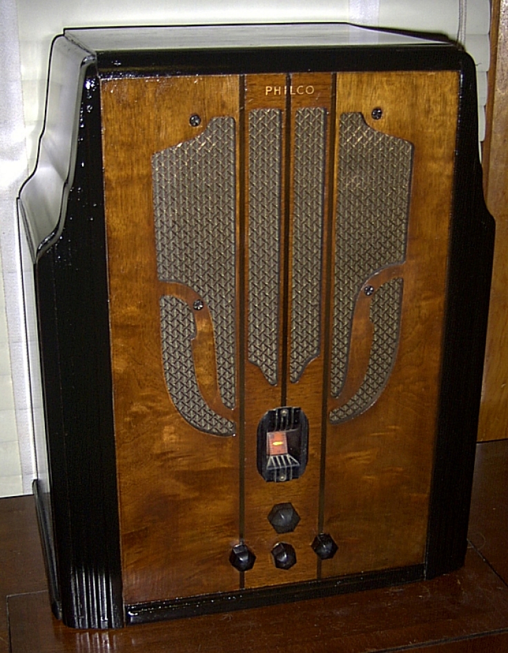

Now look at the completed set below.
[Image: http://www.philcoradio.com/images/phorum...89_025.jpg]
As I said before...it is not perfect...but considering the condition both chassis and cabinet were in...it's a pretty nice transformation, I would say.
This is already my favorite radio...because I brought both cabinet and chassis back from pure junk...and with the modifications to the chassis, this set will outperform any stock 89. Icon_biggrin
Gotta say, good job Ron Icon_wink
